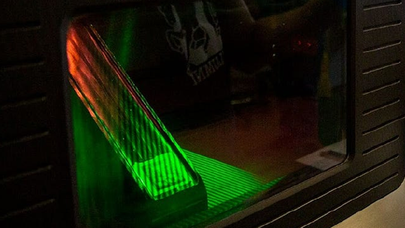

Phase3D has announced the release of two new large-format Fringe Inspection Systems for metal additive manufacturing. The new systems, Large Format Fringe Inspection and Large Format Fringe Inspection Hi-Rez, extend Phase3D’s in-situ inspection technology to support the EOS M 400 series of printers and other large-format platforms such as the Nikon SLM NXG product line. Both can be retrofitted to additional machines with build areas up to 600 x 600 millimeters.Â
Fringe Inspection is the industry’s only in-situ structured light inspection system that delivers unit-based, quantitative measurements during the additive process. Using structured light projection and proprietary calibration, the systems achieve ±10 µm vertical accuracy, 60 µm spatial resolution, and repeatability of 5 µm at the calibration plane. These measurements provide real-time insight into layer height, deposition consistency, and melt surface quality, all critical for detecting anomalies such as short feeds, chatter, protrusions, over-melting, and recoater interference.Â
