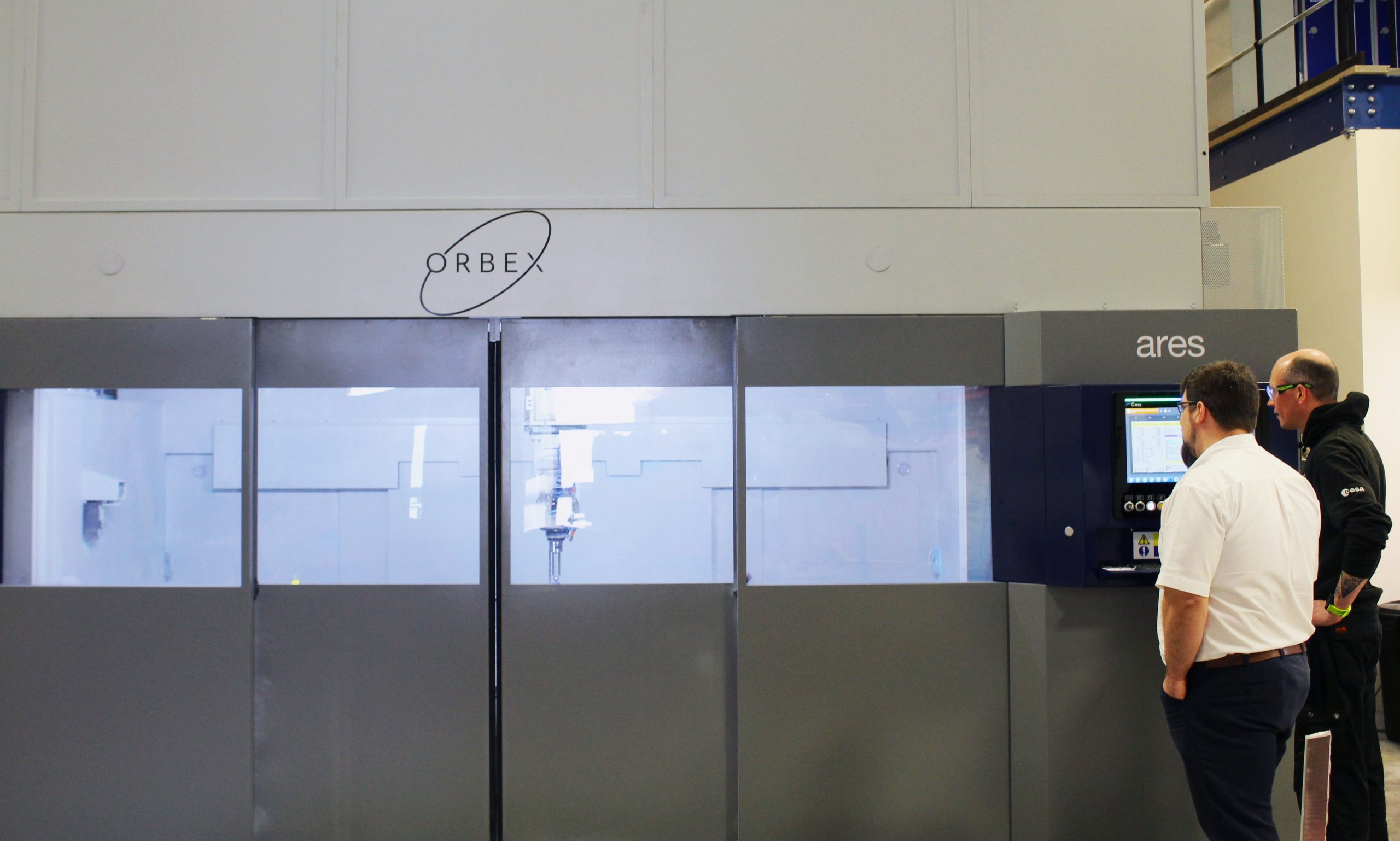

To solve Orbex’s part alignment challenges, the next product from MSP’s PerfectPart suite, NC-PartLocator was introduced. NC-PartLocator is well-suited to aligning complex, distorted or thin-walled parts. The software measures the part using 5-axis probing and automatically generates a best fit alignment in 6-degrees of freedom. The software compensates for discrepancies between the physical part location and the nominal machining program, for example, when distortion has occurred. The updated alignment is automatically uploaded to the controller, no additional machining program edits necessary, and any misalignment errors are automatically removed.
Gavin advocates: “When you press the Go button, you can see the alignment coming through and know you’re going to get out exactly what you expect. And the speed with which everything is set up – it’s made life easier”.
