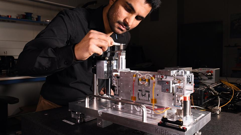

Bringing its cutting-edge invention to the larger world for the first time, the USA National Institute of Standards and Technology (NIST) has delivered a portable and super accurate tabletop instrument for measuring mass to the U.S. Army, potentially revolutionizing critical measurements in a variety of applications, from weighing aircraft components to delivering exact doses of medicine.
NIST delivered the mass measurement instrument, known as a tabletop Kibble balance, to the U.S. Army Redstone Arsenal near Huntsville, Alabama, in early April. This marks the first time in the U.S. that a tabletop Kibble balance has been put into use outside of NIST.
“This is the first Kibble balance that is out in the wild,” said Stephan Schlamminger, NIST physicist. “The Army are good early adopters of this technology because they have a measurement lab and they have trained staff. This is the best type of place to test these devices in the field.”

The Kibble balance, originally a massive and expensive research project, has been a game changer in mass measurement. However, its size and cost have made it inaccessible to many. Recognizing this limitation, NIST set out to make this technology more widely available by creating a much smaller and more portable version.
“We want to get this technology out of the measurement lab and into the hands of industry so that they can realize mass for themselves without having to rely on the primary Kibble balance at NIST. We want to put ourselves out of business,” said NIST mechanical engineer Leon Chao.
