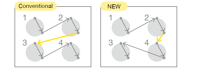

Measurement path optimization identifies the fastest route between measurement points to shorten total measurement
Optimized Measurement Paths: Automatic Measurement Path Optimization, when using CAD reference macros, identifies the fastest route between measurement points to shorten total measurement time.

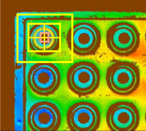

Search and Height Single Measurement can be performed simultaneously in one step
Faster Height & Search Measurements: With a single probe, search and height measurement can be performed simultaneously in one step. This reduces cycle time and enhances reproducibility.
