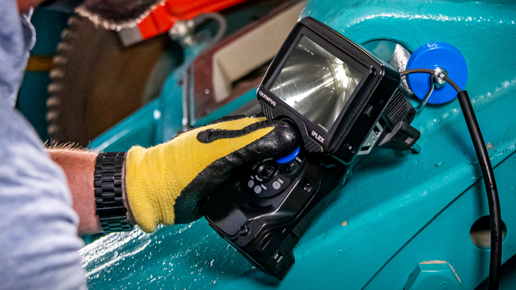

The videoscope’s optics balance the need to see areas of the wind turbine gearbox up close, such as bearings and gear teeth, spot defects in large spaces and be small enough to fit into the spaces between turbine bearings to look for damage. An optional LED guide tube offers ample illumination to spot defects in large, dark spaces while the semiflexible guide tube makes it easy to position the videoscope to capture images. Users need just one hand to control and maneuver the 4 mm scope to difficult-to-reach areas.
Easy to Carry and Clean
Weighing only 1.16 kg (2.56 lb), the compact IPLEX G Lite-W videoscope is easy to carry safely to the top of a wind tower nacelle. Its ergonomic design enables users to control it while wearing gloves in tight confines. When the inspection is complete, the scope’s smooth, oil-resistant coating makes cleaning fast and simple.
