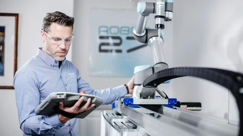

Compatible with various cobot sizes and brands, including Universal Robots (UR), the Movotrak integrates effortlessly into existing setups. Programming is simplified through the URCap interface, enabling direct configuration via the UR Teach Pendant. The free drive functionality allows users to manually position the cobot along the 7th axis and set waypoints with a single button press. This intuitive process mirrors the ease of programming cobot joints.

- Allows hand-driven movements for setting linear waypoints directly on the UR Teach Pendant.
