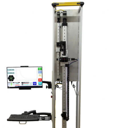

The Metron system is purpose-built to inspect parts up to 1.8 meters (72 inches) in length and 29.2 mm (1.15 inches) in diameter, making it an ideal solution for manufacturers of medical devices, precision tubing, and extruded wire. By automating the inspection process, Metron removes the dependency on manual gauges, multiple fixtures, and trained operators—streamlining workflows while boosting accuracy and repeatability.
Comprehensive Dimensional Profiling

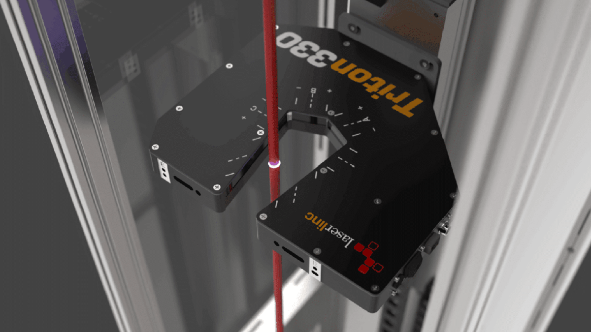

At the core of the system is LaserLinc’s triple-axis laser micrometer paired with a motorized vertical scanning slide. This combination enables Metron to perform full-length, high-resolution diameter mapping, offering measurements including Outside Diameter, Ovality, Length and Taper
Additionally, the system features a Motorized Part Holder (MPH) to simplify part placement, and Motorized Part Rotation (MPR) for 360-degree inspection—ensuring complete dimensional characterization. A built-in light curtain enhances operator safety by halting system movement when the inspection zone is accessed.

Metron’s hardware is enhanced by LaserLinc’s Total Vu software platform, which offers powerful tools for process monitoring and statistical quality control. Key capabilities include:
Real-time statistical process control (SPC) with pass/fail feedback
Customizable recipes for rapid changeovers
Reporting, trend analysis, and full data traceability
Seamless export to external quality management systems
