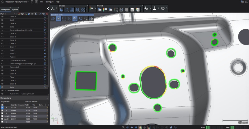

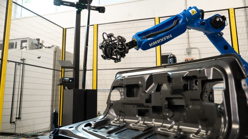

Creaform’s Dedicated 3D Scanner and Software for Sheet Metal
The MetraSCAN-R BLACK+|Elite HD is a specialized 3D scanner designed for parts with numerous edges, trims, and boundaries—essentially, sheet metal components. With 69 laser lines and 3,000,000 measurements per second, it provides an optimized field of view for inspecting even the most challenging sheet metal parts.
The Inspection software, paired with the Sheet Metal Add-On, features advanced algorithms developed specifically for sheet metal inspection. It also employs density indicators—available both in offline simulation and during 3D scanning—to provide intuitive visual feedback through a red-yellow-green color code, enabling rapid validation of measurement accuracy.

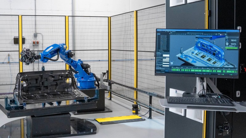

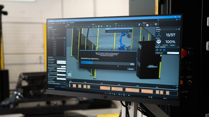

Automated Workflow – From Inspection Plan to Robot Trajectory
The Creaform solution goes even further. Inspection plans can now be imported automatically from a CSV file, ensuring error-free transfer of entities from the manufacturer’s Data Management System to the Inspection software. This automatic import capability streamlines the migration of CMM inspection programs, which is particularly valuable for sheet metal parts that often contain hundreds of points to inspect.
Robot trajectories can then be automatically generated from imported inspection plans, using the same density indicators to ensure complete coverage and optimal accuracy. This capability integrates 3D scanning best practices, enabling any user—regardless of robotics experience—to program accurate trajectories correctly on the first attempt.
