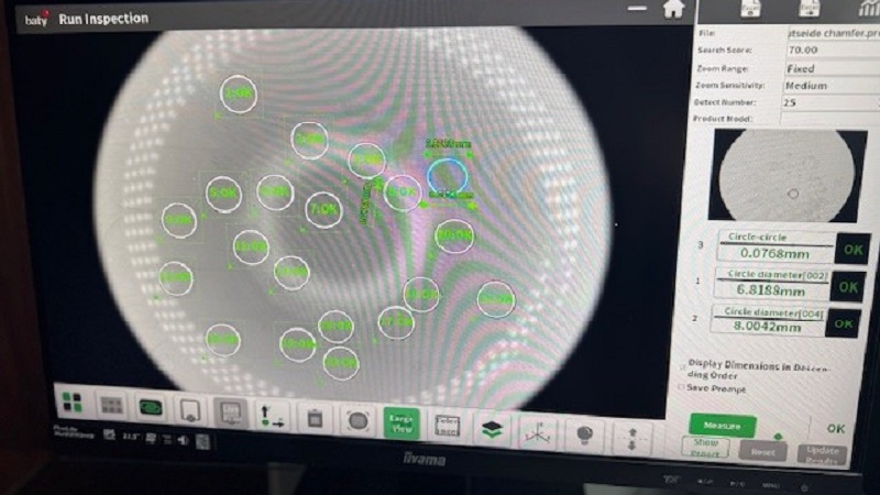

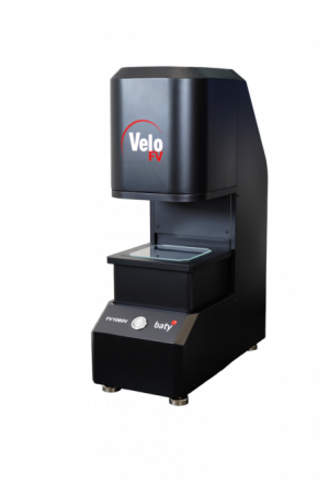

To address this, Metallo invested in the new Baty Velo FV, a compact automated optical inspection system supplied by Bowers Group. Designed for fast, repeatable measurement of precision components, the system enables multiple features to be inspected in a single cycle with minimal operator input.
Commenting on the investment, Jordan Higgins, Managing Director at Metallo, said the introduction of the system had transformed the inspection process. “Quality inspection is no longer a hurdle with the implementation of the Baty Velo. The inspection system is unbelievable in speed and accuracy, and because it is so simple to use, it requires very little training,” he said. “A quality inspection which previously took hours is now completed in minutes, with even more accurate results.”
The Velo FV is now used daily by both engineering and quality teams to measure a wide range of components, from parts as small as 1mm in diameter up to components measuring 40mm.
By automating inspection routines, the system has significantly reduced reliance on traditional manual measurement tools for many applications. Since installation, Metallo has achieved an average reduction in inspection times of around 30 percent on parts that were previously measured manually.
This improvement has helped accelerate production flow while increasing confidence in measurement accuracy and consistency. The straightforward operation of the system has also meant it was adopted quickly, with minimal training required.
