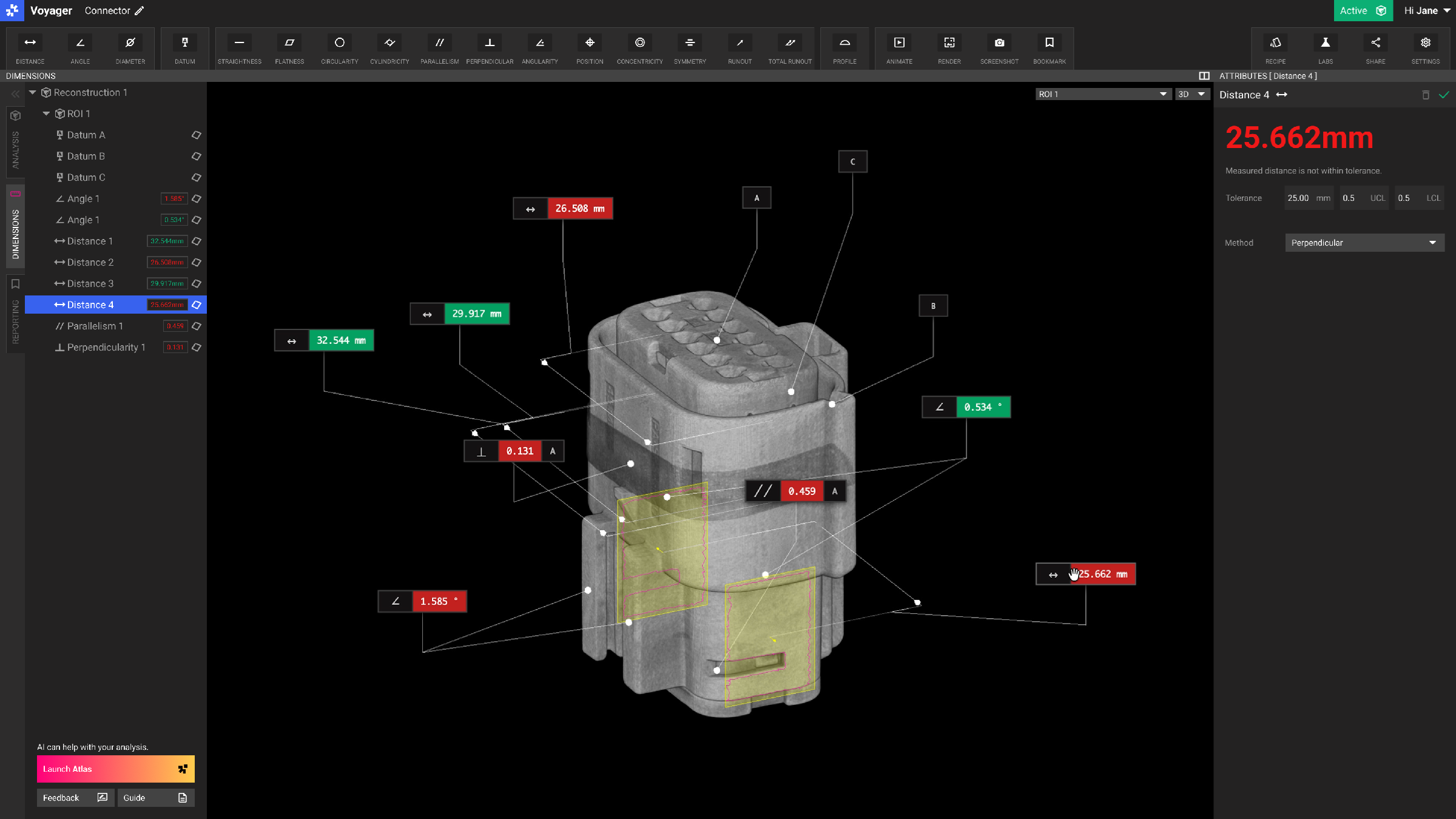

With Auto-Dimensioning, Lumafield’s CT scanning technology now recognizes geometric features and measures geometric and dimensional tolerances such as flatness, parallelism, and profiles. The system automatically extracts internal and external dimensions from a single, non-destructive scan. Auto-Dimensioning builds on Lumafield’s new NIST-traceable calibration process, a workflow that uses a reference artifact with a documented calibration chain. Lumafield’s new calibration process ensures consistent, repeatable accuracy across every scanner and every site, giving engineers the confidence of NIST-traceability in a seamless, automated workflow.

Faster Dimensional Inspections: Simple, intuitive verification of geometric and dimensional tolerances in a fraction of the time that it would take with a CMM and minimal fixturing.
Greater Coverage: Measure internal and complex external geometries such as overhangs in a single scan to inspect a wide range of features.
Broader Material Capability: Accurately measure clear, reflective, and soft materials that OMMs and CMMs cannot.
Confidence and Accuracy: Powered by a NIST-traceable calibration workflow, Auto-Dimensioning delivers high accuracy, highly repeatable measurements.
