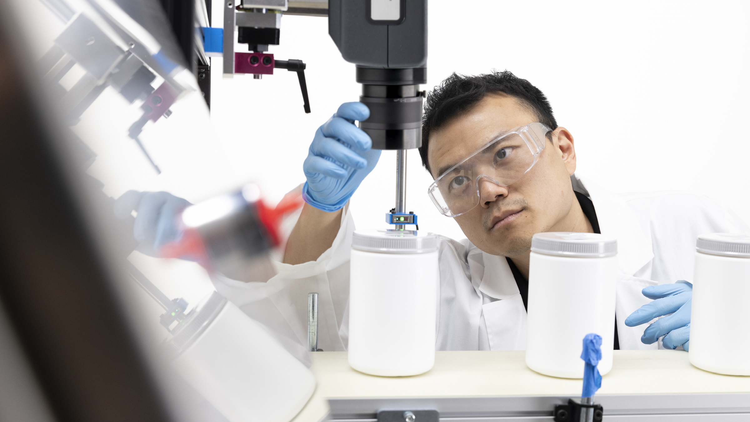

The A6450 is designed for applications where timing is critical. With a 125 Hz frame rate, the camera accurately captures fast thermal events and subtle temperature variations on moving products capabilities essential for non-destructive testing, process monitoring, and inline quality assurance.
High thermal sensitivity allows users to detect early-stage defects, material inconsistencies, or process deviations before they propagate downstream, helping reduce scrap, rework, and unplanned downtime.

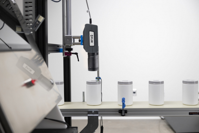

Built on proven industry-recognized Flir A6700-Series electronics, the A6450 supports GigE Vision, GenICam, and other industry standard protocols, enabling seamless integration into existing automation systems. Customer-driven interfaces, commands, and triggers, allow system integrators to deploy the camera quickly without custom development.
For pre-deployment testing and validation, the A6450 offers plug-and-play compatibility with Flir Research Studio, enabling users to test, tune, and validate inspection setups before full system integration.
