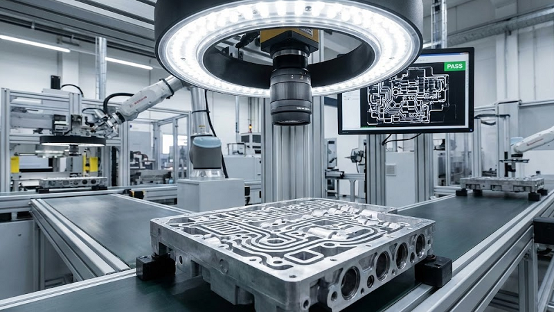

Rings and bars deliver adjustable, directional light that can be tilted to balance glare and contrast. Domes provide a diffuse, multi‑bounce field that tames speculars on curved plastic. Coaxial illumination injects light along the optical axis and pairs naturally with telecentric optics for planar, polished parts and laser‑etched codes. Backlights remain the gold standard for dimensional work when silhouettes are feasible. Laser triangulation and confocal sensors live or die by the quality and polarization of the return spot, while structured‑light scanners require projected fringes that dominate ambient and cooperate with the material’s BRDF.
