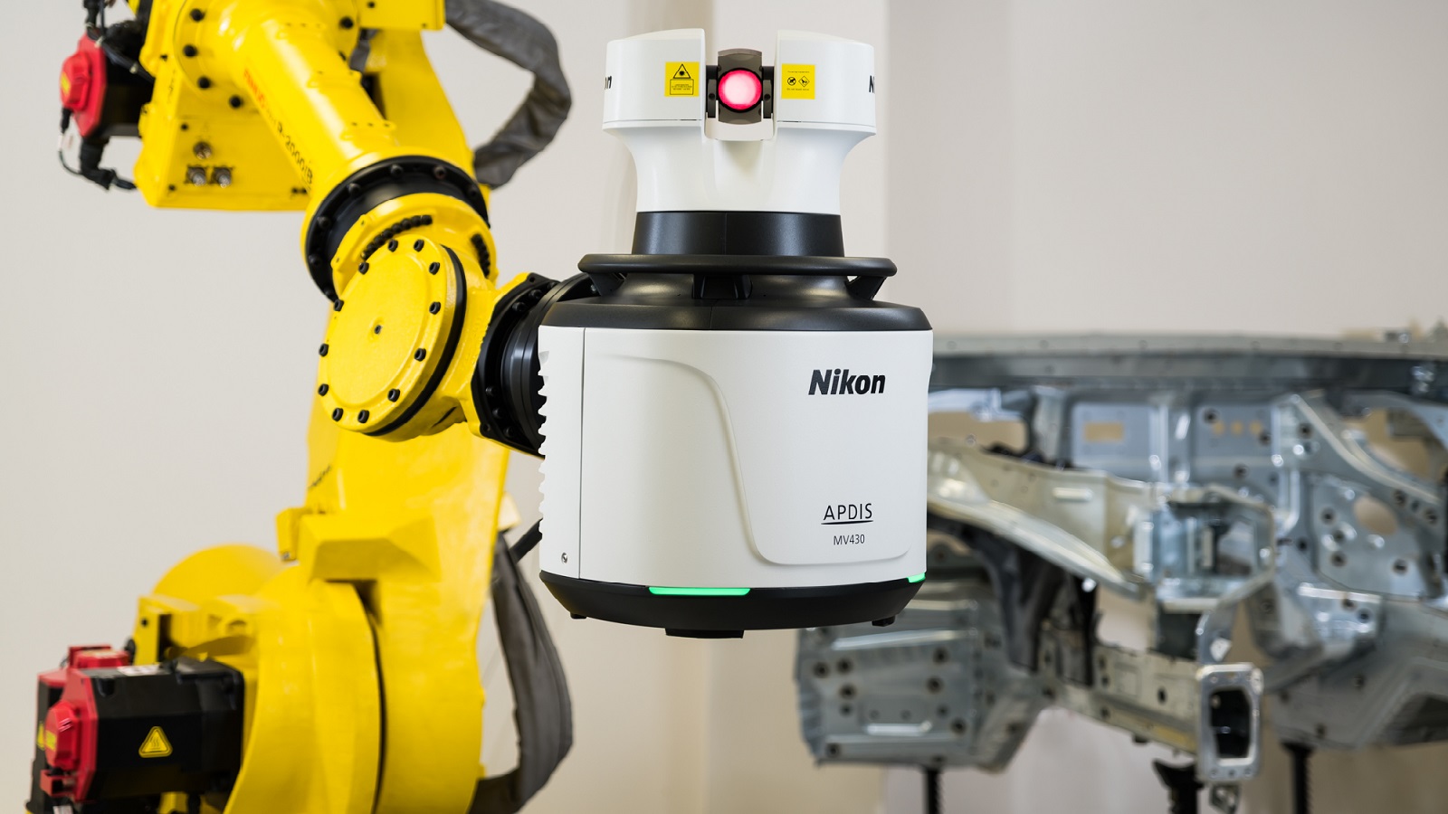

“We already offer innovative, traceable measurement solutions based on national and international standards for the automotive industry,” explains Andreas Fuchs, application engineer at Nikon Metrology. “The new standard defines very precisely the procedures for evaluating the precise technology that we provide. After all, with the APDIS Laser Radar, our portfolio has featured a product for some time now that can also deliver traceable inline measurements as described in VDA Volume 5.1. Incidentally, those who use this technology no longer need a dedicated measuring room for a fixed CMM – enabling them to save a great deal of money, time and space.”
The APDIS Laser Radar represents a proven ability to measure details at a distance without needing handheld probes, targets, or surface preparation which makes it ideal for automating repetitive inspection tasks with high accuracy. The system covers many manufacturing, industrial, and research applications, including those that involve hard-to-reach features and are complex, delicate, or labour-intensive.
The additional benefits of the APDIS Laser Radar include fast and accurate automated measurements with minimal set-up time for maximum productivity with flexible and portable installation. This allows for the absolute and accurate measurement of parts during production or wherever required, including directly on the production line. The APDIS Laser Radar, in particular, displays its strengths in the automotive industry. For example, the system can measure automotive features with absolute accuracy at high speed with no part preparation, whether inline or offline.
