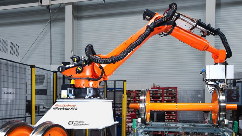

Waygate Technologies, a leader in nondestructive testing (NDT) solutions for industrial and energy infrastructure inspection, has expanded its advanced inspection solutions portfolio for the rail industry with the introduction of the Krautkrämer WheelStar RPS*. A fully automated ultrasonic testing system that is combined with proprietary matrix technology, the Krautkrämer WheelStar RPS ensures precise results and cost reductions in the inspection process of dismantled train wheels,  helping train operators and Maintenance, Repair & Operations (MRO) facilities keep up with growing regulatory requirements, as well as increase reliability and maximize train utilization.
Robotics Combined with Matrix Ultrasonic Technology
WheelStar RPS uses a robotic assembly to position the ultrasonic mechanics on the train wheels. As part of a fully automated process, the wheel is rotated by an underfloor shift-rotate unit while the inspection is facilitated using proprietary Waygate Technologies phased array matrix probe technology, which allows a very compact design and ensures reduced complexity at the same time. Results are then compared with calibration data. Once the first wheel has been inspected, WheelStar RPS moves on to the second wheel without any need for manual intervention, resulting in a cycle time of just six minutes per wheelset.
Check and re-check are performed automatically, eliminating the need to manually handle reference wheelsets. The combination of innovative matrix technology and highly efficient industrial robots paves the way for intelligent and fast inspections of wheels in service, completed within a reduced time frame.
