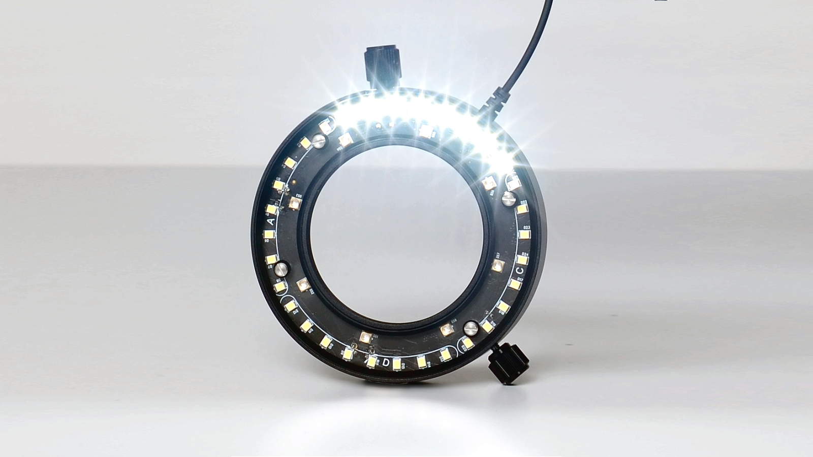

INSPECTIS AB has announced the release of its new HD-124-WUV Dual White & UV Ring Light, a high-performance illumination solution designed to enhance inspection capabilities when used with INSPECTIS digital microscopes. The new ring light will make its official debut at the IPC/APEX Expo, taking place March 14–19, 2026, at the Anaheim Convention Center, USA where it will be showcased in partnership with Microscope World.

“Our new HD-124-WUV is an industrial-grade ring light containing 32 white, and 8 high-power UV LEDs arranged along two rings. This feature-packed unit is designed for applications where sequential or independent white and UV illumination is needed. It offers homogeneous, high-intensity light output and features an integrated On/Off switch with electronic dimmer. It also features dedicated switches for UV and segment control.”
This dual-mode illumination capability allows inspectors to quickly switch between white and UV light or use them independently, supporting a wider range of inspection tasks without requiring multiple lighting systems.

A key advantage of the HD-124-WUV is its direct integration with INSPECTIS digital microscopes. The ring light is powered directly through the microscope system, eliminating the need for external power supplies and reducing cable clutter. This streamlined configuration supports cleaner workstation layouts and improves overall ergonomics.
The ring light also incorporates several practical features that enhance usability:
  • Integrated On/Off switch with electronic dimmer
  • Independent UV activation control
  • Segment control for directional illumination
  • Detachable diffuser for soft, uniform lighting
  • Optional polarizer/analyzer filter kit to reduce glare and reflections
Segment control is particularly useful for revealing surface textures and subtle defects by enabling directional lighting. Adjusting illumination angles can highlight scratches, dents, or surface irregularities that might otherwise remain hidden under uniform lighting.
The optional polarizer/analyzer kit further enhances inspection quality by minimizing reflections from shiny surfaces, which is especially important when inspecting metallic components or solder joints.
