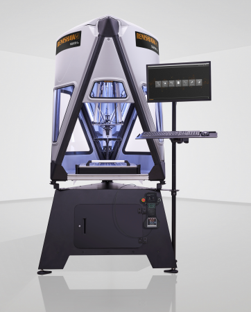

Renishaw has announced the launch of its latest pioneering solution for shop floor process control, the Equator–X 500 dual-method system. This innovative product brings unique capabilities to manufacturers around the world, enabling them to select the optimum inspection method, Absolute or Compare, for their process challenge, effectively deploying two systems in one.
The Equator–X system has been designed to address the challenges for shop floors where product variety and frequent design changes require measurement systems that are able to provide speed, flexibility and ease of use to keep pace with machining capabilities. Key benefits include increased throughput and inspection capacity; fully traceable in-process verification of parts on the shop floor, continuous validation of the production process; and the flexibility to select the optimal measurement method for each application with a single device.

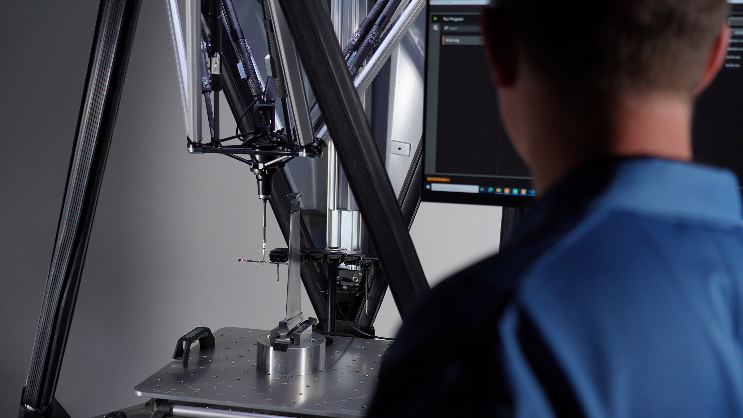

In Absolute mode, the Equator–X system measures parts at scanning speeds of up to 250 mm/s, significantly improving the inspection capacity and throughput for manufacturers of small to medium batch sizes and high part variety. This mode is particularly useful for first-off verification next to the machine or even at-line 100% inspection.
In Compare mode, the Equator–X system delivers an ultra-high scanning speed of up to 500 mm/s and is ideal for inspecting large batches of the same component when cycle time is a priority. It also provides a high-speed measurement option where varying thermal environments present a challenge.

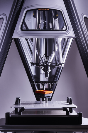

The Equator–X 500 gauge is a hexapod structure with independent drive and metrology frames. High-speed motion is achieved without compromising metrology thanks to design features such as carbon fibre metrology struts, linear motor drives and the industry standard SP25M scanning probe.
The system can be deployed as a standalone shop floor device or integrated within a fully automated cell, offering unrivalled flexibility to adapt to evolving demands and variable shop floor conditions.
