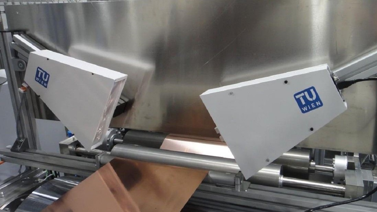

Conventional ellipsometry is confined to the lab because foil widths of several meters demand collimated illumination across enormous apertures. TU Wien’s solution: replace conventional refractive optics with large-aperture Fresnel lenses, collapsing cost and footprint while preserving the precise angle-of-incidence control ellipsometry demands. The result is the first imaging-ellipsometer deployed in an active R2R production line, demonstrated on 300 mm foil.

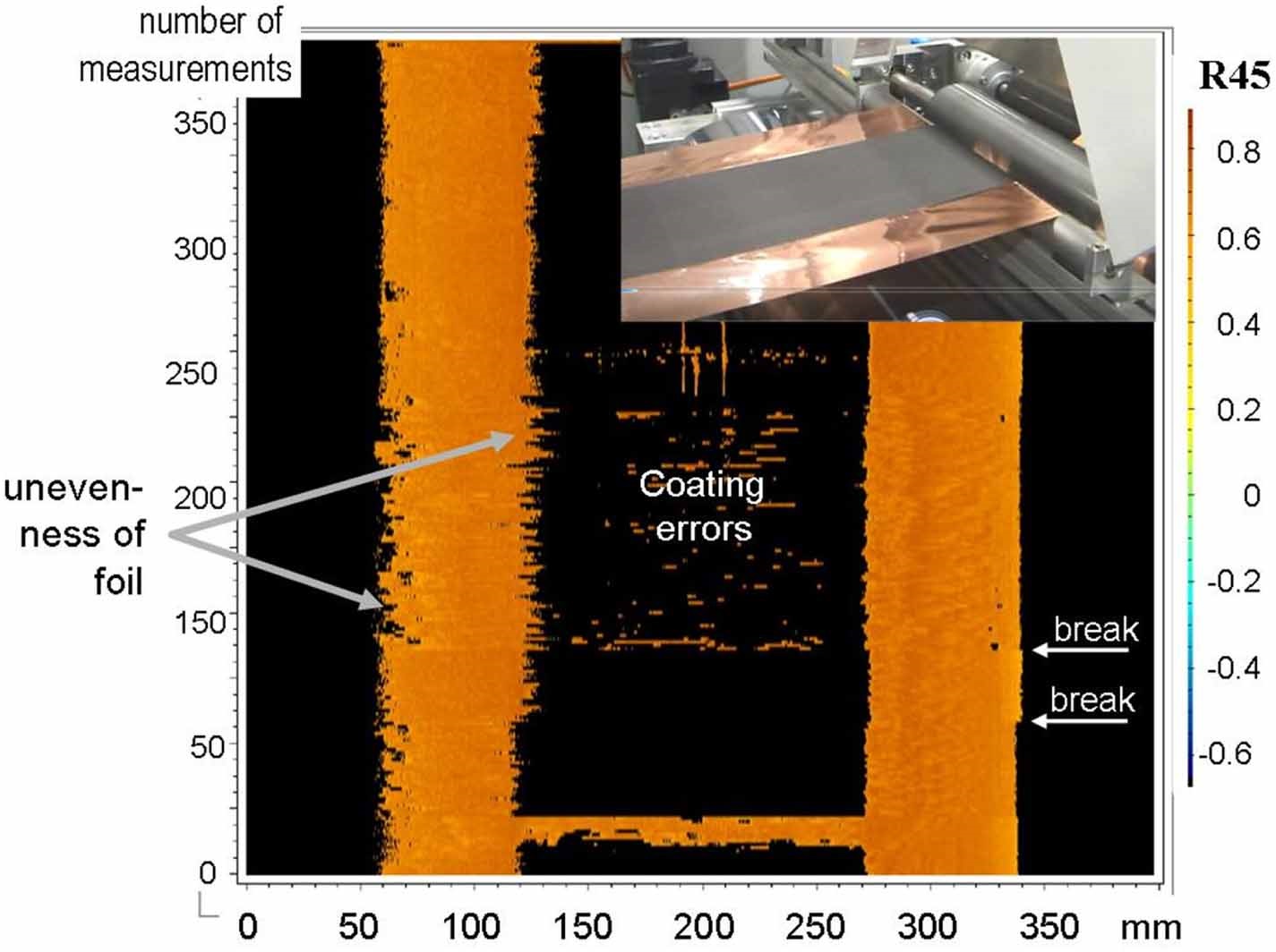

The system was tested on PEDOT layers on PET foil (organic electronics, transparent electrode manufacturing) and battery electrolyte coatings on copper foil. In both cases it delivered quantitative thickness maps at production speed. Critically, polarimetric sensitivity reveals coating uniformity deviations, edge anomalies, and surface defects invisible to conventional optical inspection with direct implications for yield improvement and early defect rejection.

Foil vibration, backside reflections, substrate birefringence — each has historically made reliable inline ellipsometry all but impossible. The system addresses all of them with one architectural decision: measurement directly on a roll. On-roll geometry suppresses vibration, fixes the effective AOI, and redirects backside reflections away from the detector. The LED’s 20–60 nm spectral bandwidth ensures front- and back-surface reflections are mutually incoherent, eliminating interference artifacts at the physics level.
