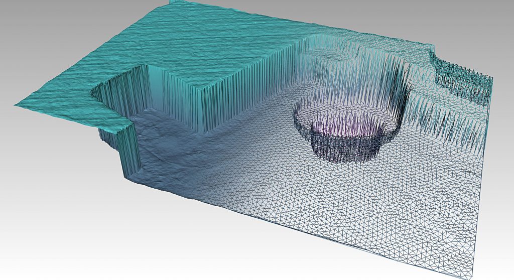

Inline computational imaging methods can be used to visualize and measure the finest structures on surfaces of a wide variety of objects.
