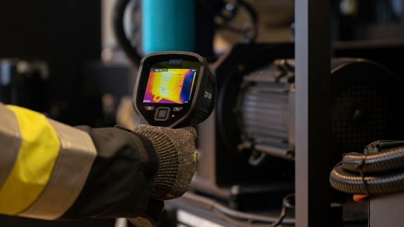

Measuring Temperature
At its core, thermography involves capturing temperature readings of an asset. A singular temperature reading can offer insights, yet its standalone value might be some what limited. Consider an electrical motor in a factory running at 73°C (163°F). Without additional data, is this concerning? To ascertain this, one might need to delve into the specifics of the motor, examining its standard operating temperature range. Yet even that might not offer a complete picture.
For instance, if the standard range of the motor is from 50°C (122°F) to 80°C (176°F), at 73°C (163°F) the motor currently runs at the higher end of this range. However, how frequently should it be inspected? Whatâs the current condition? When is maintenance required? Will it fail? These questions remain unanswered, and we have no ability to predict the future condition of this motor.
