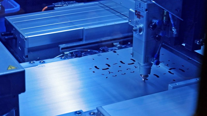

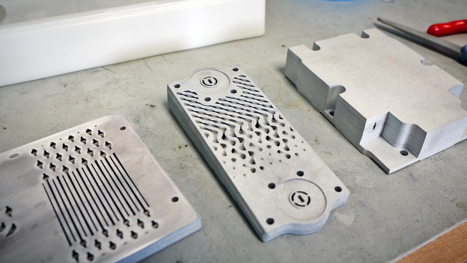

Instead of iterating on flawed processes, they decided to build a new one. That became Stack Forging, Alloy’s patented manufacturing process. It uses laser-cut sheets of metal rather than powders, bonding them under controlled heat and pressure into solid components that contain an inner world of complex internal geometries. The resulting parts are monolithic, free of porosity, and structurally robust.
Alloy’s process opens the door to manufacturing features that would be cost-prohibitive or technically out of reach using machining or traditional additive methods. And because it scales easily, it supports the needs of customers designing for production instead of just prototypes.

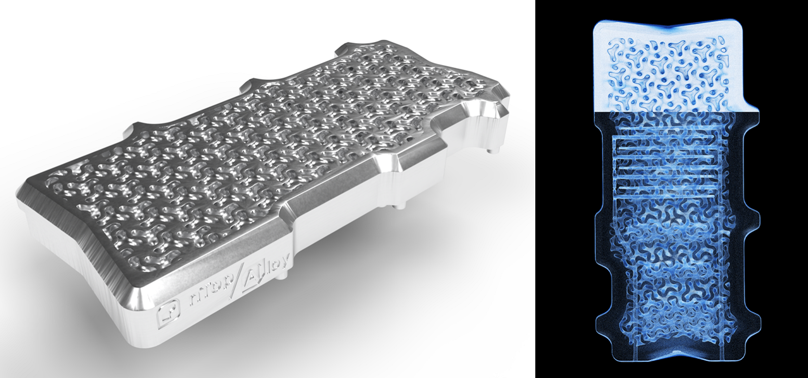

- 180-micron microcapillaries direct coolant flow with high precision to regions of peak thermal output.
- Massively parallel inlet and outlet channels minimize flow length and keep pressure drop extremely low, ensuring even performance across the cold plate.
- A gyroidal TPMS (triply periodic minimal surface)Â provides internal support and maximizes surface area while maintaining a total part weight under 550 grams.

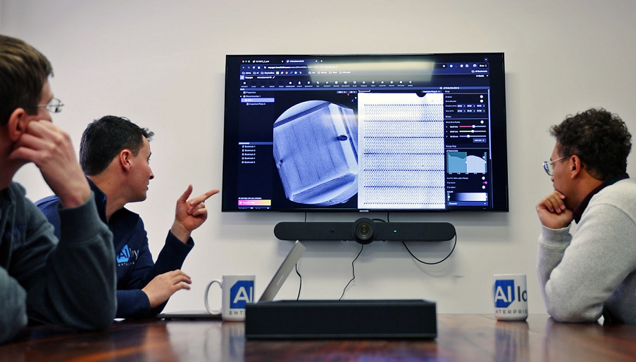

With CT scanning, Alloy’s engineers can inspect internal features down to the micron level, validate dimensional accuracy, and confirm that the geometry matches the intended design. The non-destructive process allows the part to remain intact, saving on scrap. And instead of inspection creating a bottleneck, industrial CT supercharges development timelines. Scans are fast, accurate, and easy to share.
Voyager, Lumafield’s browser-based analysis tool, puts powerful quality workflows at Alloy’s fingertips. Engineers can review scan data, run measurements, annotate areas of interest, and share findings with both internal stakeholders and customers. That transparency changes the dynamic of customer collaboration.
“Showing customers the inside of their own components gives us an opportunity to demonstrate the capabilities of our technology” comments Ali Forsyth, CEO, Alloy Enterprises.
