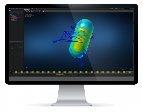

The introduction of 3D scanning bridges the gap between digital models and physical components. It captures high-resolution 3D data, allowing engineers to compare manufactured parts against CAD designs with exceptional accuracy. The traceable data a 3D scanner provides supports compliance, certification, and continuous improvement.
Role of 3D Scanning in AM

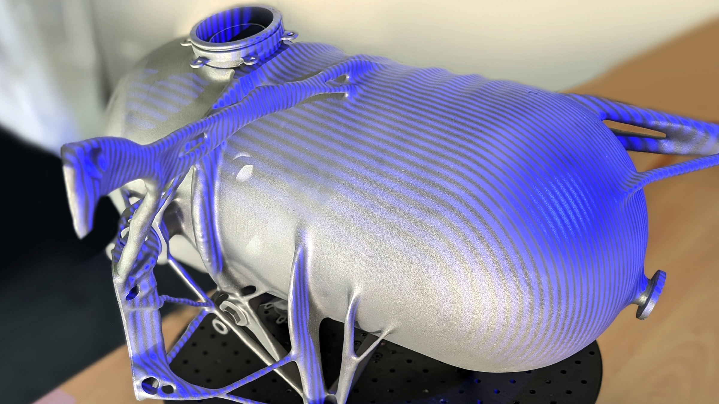

As AM components grow increasingly complex, traditional inspection methods fall short. Scanning provides a comprehensive solution, delivering micron-level precision with structured light or laser technology. It not only captures intricate geometries with exceptional accuracy, but also provides valuable feedback for iterative improvements, enabling engineers to refine designs and production processes. This approach supports first-time-right production, reducing costly trial-and-error and accelerating time-to-market.
For instance, in an air separator project with a leading aerospace supplier, a Hexagon SmartScan VR800 structured light scanner validated the final component, confirming the dimentional accuracy of the printed part within ±0.25 millimetres. This level of precision ensures both functionality and safety in aerospace applications. By integrating 3D scanning early and throughout the AM process, manufacturers achieve a closed-loop quality system that guarantees repeatable, high-quality results.

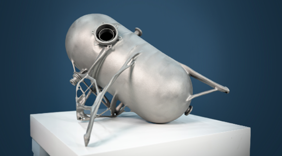

Case Study: Aerospace Air Separator

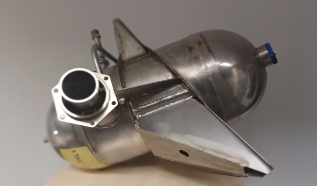

Conventional air separator with over 30 components
In aerospace, even the smallest deviation can affect safety and performance. Faced with the challenge of creating a lighter, more efficient air separator, engineers turned to AM combined with high-precision 3D scanning.
The goal was to reduce the component’s weight by half, simplify assembly, and meet strict aerospace tolerances, all while improving sustainability.
Redesigned air separator meets structural requirements
Through generative design, the team created an optimised structure that balanced strength and weight, while simulations ensured it could withstand real-world loads before production began. Once manufactured, structured light 3D scanning confirmed the dimensional accuracy of the part to be within ±0.25 mm, ensuring compliance with aerospace standards.
The results exceeded expectations:
  • 75% weight reduction, exceeding the initial 50% target
  • Over 30 parts consolidated into one integrated component
  • 246 tonnes of CO₂ savings projected across the aircraft’s lifecycle
