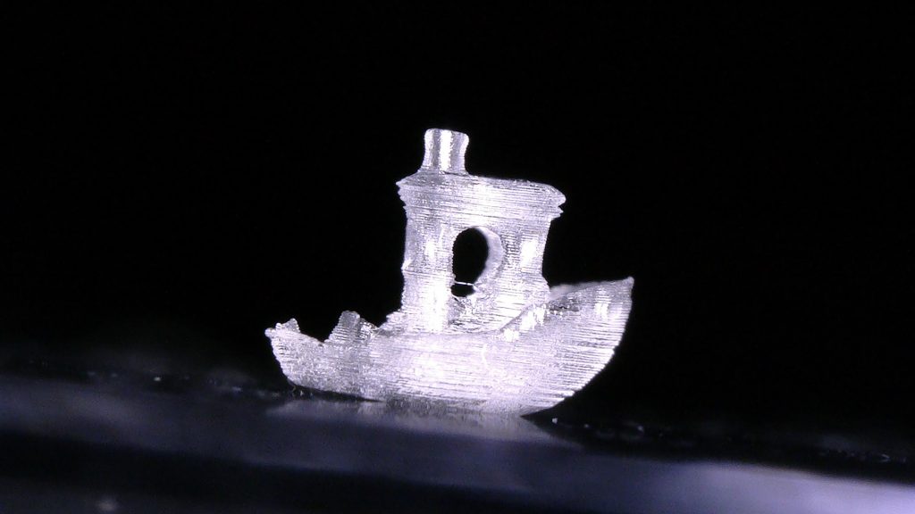

In the recently published work, the team printed complex 3D objects such as miniature boats, spheres, cylinders, and art pieces in under 60 seconds with exceptional accuracy, using 25 times less optical power than previous studies.
The holograms are generated using a technique called HoloTile, which was invented by Glückstad. HoloTile involves superimposing multiple holograms of a desired projection pattern, and eliminates random light interference called speckle noise that would otherwise create grainy images. Although holographic volumetric additive manufacturing has been reported previously, the joint EPFL-SDU team’s approach is the first to yield such high-fidelity 3D-printed objects, largely thanks to the use of HoloTile.
