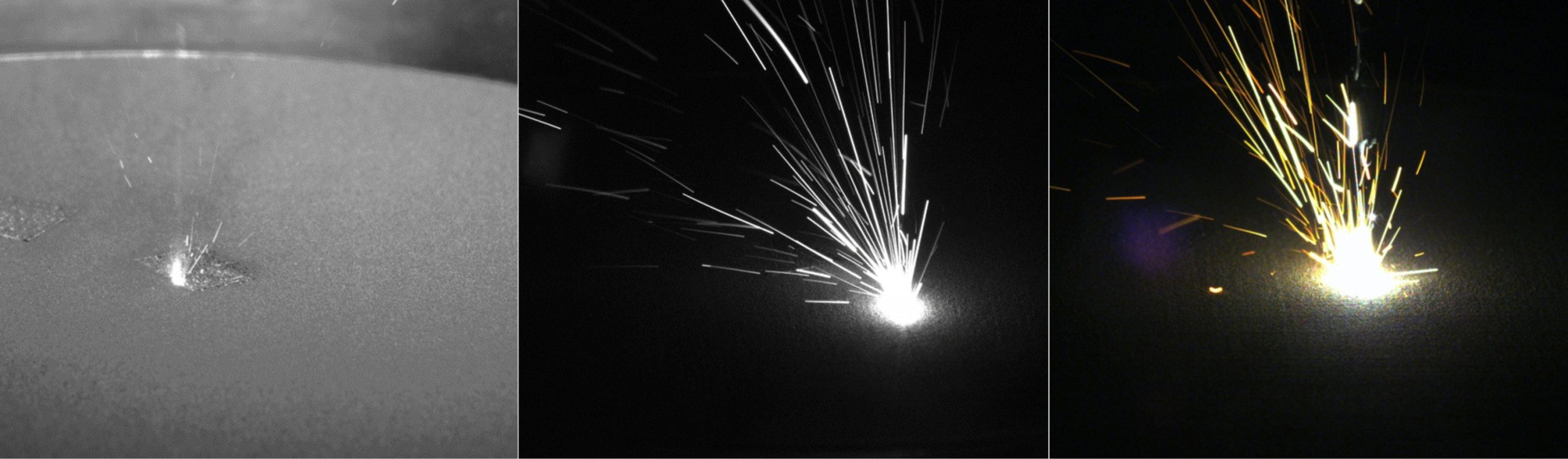

“Since powder bed-based laser beam melting of metals is a highly dynamic additive manufacturing process in which the component is generated layer by layer, the following features were particularly important for global, dynamic monitoring: The camera must offer a resolution of more than 1000 x 1000 pixels and a frame rate of more than 100 fps, cover an image field of at least 100 mm x 100 mm and have a trigger port for video recordings,” says David Kolb, explaining the choice of camera model. The selected U3-3040CP-C-HQ Rev.2.2 ensures excellent image quality even in low light conditions or when recording fast-moving objects. The integrated IMX273 global shutter CMOS sensor from Sony’s Pregius range scores particularly well for its image quality, high sensitivity and wide dynamic range. With a resolution of 1.58 megapixels (1456 x 1088 px), it achieves a frame rate of 251 frames per second – ideal for detailed video and image analysis of dynamic processes.
The video sequence / image shows the layer-by-layer PBF-LB/M process with different laser parameters, recorded using the IDS peak software. “Depending on the setting of the industrial camera, various process properties such as material evaporation or the quantity and direction of splashes during the PBF-LB/M can be observed and quantified,” says David Kolb, describing the application. “The knowledge gained from this provides us with important information to understand the laser-material interactions of the additive manufacturing process in greater depth and to be able to individually adapt the manufacturing parameters depending on the material or, for example, the component geometry.”
For the process parameter determination, cube-shaped components were additively manufactured and the global manufacturing process was analyzed with the USB3 uEye CP camera. This made it possible to identify optimum laser parameters with which new types of soft magnetic components for more efficient electric motors of the future can be produced from the difficult-to-process iron-silicon alloy with 6.5 wt.% silicon (FeSi6.5). The stator half-shell made of FeSi6.5 based on this enables ideal adaptation to the special requirements of transverse flux machines thanks to its optimized, three-dimensional magnetic flux guidance. The high electrical resistance of the material and the design freedom of the PBF-LB/M allow a reduction in eddy current losses, increased power density and the integration of additional functions such as cooling structures. Both the complex geometry and the brittle, soft magnetic material FeSi6.5 are almost impossible to produce or process using conventional manufacturing processes and require the use of additive manufacturing technologies.

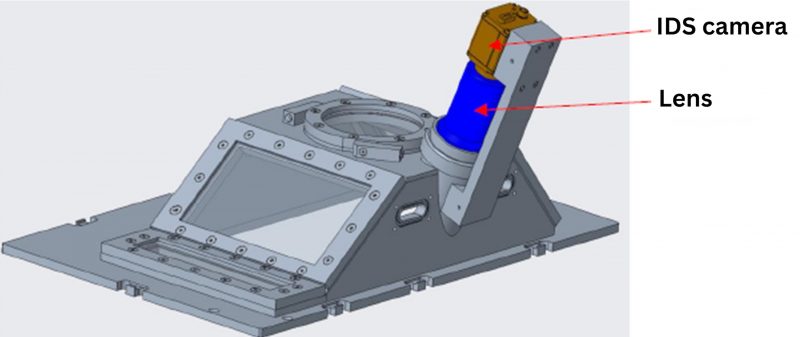

For static, high-resolution observation of powder layers or component layer geometries, on the other hand, the following camera properties are required in particular – in addition to a trigger port for single image recording: The sensor must be able to detect geometric features below 40 µm in order to identify defects in the layers, while offering an image field of at least 100 mm × 100 mm and an image ratio that is as square as possible (1:1). This is exactly what the 20.36 megapixel (4512 x 4512 px) industrial camera U3-3990SE Rev.1.2 delivers. With the IMX541, it has a high-performance, extremely high-resolution, large-format 1.1″ CMOS sensor from Sony’s Pregius S series. The BSI technology (Back Side Illuminated) used enables smaller pixels (2.74 µm) and a higher resolution, as well as improved quantum efficiency and sensitivity.
“Thanks to the particularly user-friendly and flexibly integrable IDS cameras, the necessary adjustments to the test setup could be implemented quickly and easily so that the USB3 uEye SE can be positioned at a defined angle,” explains David Kolb. The near-vertical observation of the individual powder component geometry layers will provide valuable insights into component quality and potential manufacturing defects once the final adjustments have been completed.
