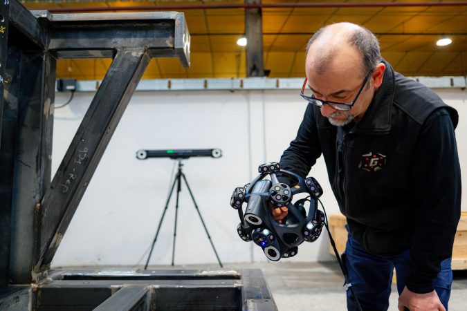

HYPERSCAN provides a high-resolution data stream with an instant start, without the need for operators to position reference targets to the part, eliminating unnecessary preparation time. Hole Flash Capture automatically detects and highlights holes during scanning, reducing manual input and speeding up inspection. Advanced edge recognition adapts to surface variability, ensuring more consistent performance across a wide range of materials.
The scanner meets rigorous quality and performance benchmarks that are certified according to VDI/VDE 2634-3 standards and validated by an ISO 17025 accredited lab. It’s best-in-class 610 x 640mm scan area, enabling users to perform fast accurate scanning of parts of up to 7m. Its high-resolution scanning is completed by multi-mode flexibility so that fine details, sharp edges and large surfaces in one seamless workflow, with no need for multiple scanners.

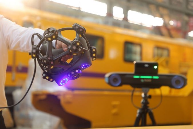

Equipped with a Wi-Fi 6/7 module with built-in battery, HYPERSCAN allows total mobility, ideal on production lines, on-site operations or in confined spaces.
The optical tracking function helps maintain accuracy even when the workpiece or operator is moving, or in vibrating conditions.

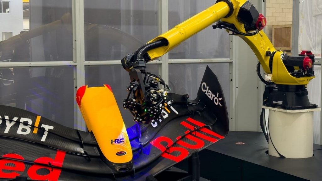

HYPERSCAN is automation-ready, easily integrated with most suppliers of rotary tables, industrial robots and cobots via the dedicated kit, as well as Hexagon PRESTO automated inspection cell solutions.
