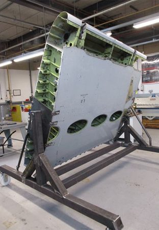

Manufacturing aircraft wings is extremely complex when considering the role of the wing in providing aerodynamic lift for the aircraft, mounting points for powerful jet engines, support for landing gear and storage for aviation fuel.
During operation, the wing must withstand significant temperature ranges (from -50 to 40 degrees Celsius) at the same time flexing during air turbulence. This makes the wing arguably the most complex and crucial component of any aircraft.
The manufacturing process involves many operations comprising different materials, material treatments and assembly of many thousands of components such as wing overs, ribs, spars, fasters, rivets and brackets.

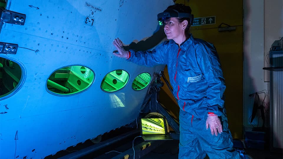

Quality inspection must be performed on the aircraft during its operational life – looking for damage to surfaces or other defects that might occur due to the stresses and strains experienced during operation. Consequently, at periodic intervals, a full internal and external inspection of the wing structure is undertaken by people. This is extremely time consuming and requires full personal protective equipment.

The Advanced Virtual Reality Research Centre (AVRRC) at the UK’s Loughborough University are developing new AI based solutions to identify potential manufacturing issues to the same level, if not better-quality standard of inspection than is currently employed. The precise research being undertaken is commercially sensitive. However, important new AI techniques have been developed that has led to a significant improvement in the accuracy/reliability of defect detection. The goal is to argument rather than replace human inspection methods.

A series of algorithms have been developed that harness the capability of multi-spectral sensors in conjunction with traditional and AI based imaging techniques.
