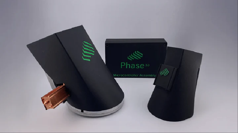

Plug-and-Play Across Printer Fleets
Phase3D has engineered Fringe Inspection to be both machine-agnostic and scalable, allowing users to deploy the system across a full fleet of PBF and BJT printers. Installed externally via existing machine ports, the Fringe Inspection Hardware Kit includes a camera assembly, projector, microcontroller, and a dedicated PC — everything needed to transform any metal AM printer into a real-time inspection and certification platform.
For example, the EOS M290 Kit provides a turn-key solution for one of the industry’s most widely used metal AM platforms. The hardware integrates seamlessly and is paired with a one-year Fringe Inspection software license, enabling rapid deployment and instant value across development or production environments.

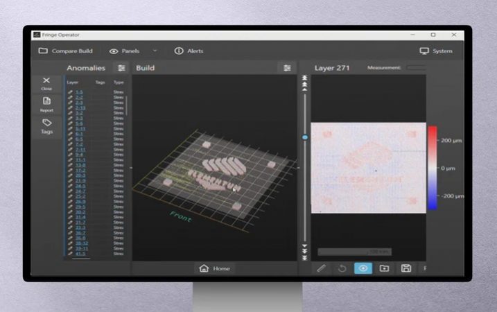

Insight in Real Time: Fringe Operator
At the heart of the Fringe ecosystem is Fringe Operator, an intuitive visualization and analytics tool designed for engineers, technicians, and process developers. Fringe Operator enables real-time, interactive analysis of every layer — transforming raw data into actionable insight.
Whether optimizing build parameters, validating geometry, or investigating print failures, users gain a powerful digital twin of the process. With Fringe Operator, teams can:
  • Identify build failures and root causes in first prints
  • Measure internal wall thickness and complex feature shapes
  • Analyze build consistency over time
  • Compare heightmap data across different machines or builds
  • Load and correlate data from external sensors and modalities
By quantifying deviations at each layer, Fringe Operator closes the gap between process development and production oversight, ensuring reliable and predictable output.

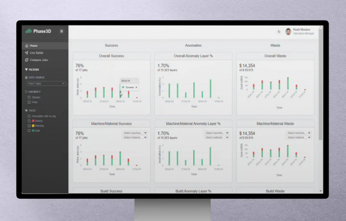

Certification at Scale: Fringe Qualification
Fringe Inspection doesn’t stop at the build chamber. For organizations seeking enterprise-level certification and control, Phase3D offers Fringe Qualification — a centralized quality assurance platform that aggregates inspection data across entire fleets and facilities.
Fringe Qualification enables:
  • Automated go/no-go decision making
  • Executive build summaries and traceability reporting
  • Fleet performance dashboards with anomaly alerts
  • Machine, material, and build benchmarking over time
With every layer’s inspection data traceable and certifiable, manufacturers can ensure process repeatability, regulatory compliance, and fleet-wide oversight — all from a single interface.
