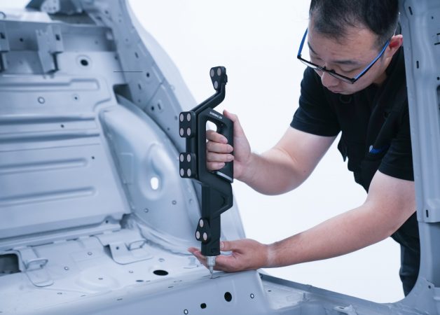

Achieving complete dimensional data in manufacturing often requires more than just high-speed scanning. Certain features like deep holes, recessed pockets, and obstructed geometries are difficult or impossible to capture using traditional optical scanning alone. To address these challenges, the FreeProbe Series from Shining3D introduces a portable, wireless, optical-based probing solution that bridges the gap between scanning and probing, ensuring no detail is overlooked.
Designed for Challenging Measurement Scenarios
The FreeProbe Series was built to excel in scenarios where precision point probing is essential. Whether it’s a narrow slot or a blind hole buried deep within a complex assembly, FreeProbe enables metrology teams to capture hard-to-reach features without compromising accuracy or workflow efficiency.

Multiple Tip Options for Greater Reach
Flexibility is central to FreeProbe’s design. The system supports various probe tip extensions and modular configurations, including L-shaped assemblies. This adaptability ensures users can configure the probe to match the task at hand, whether measuring recessed internal features, inspecting tight pockets, or reaching into deep bores.

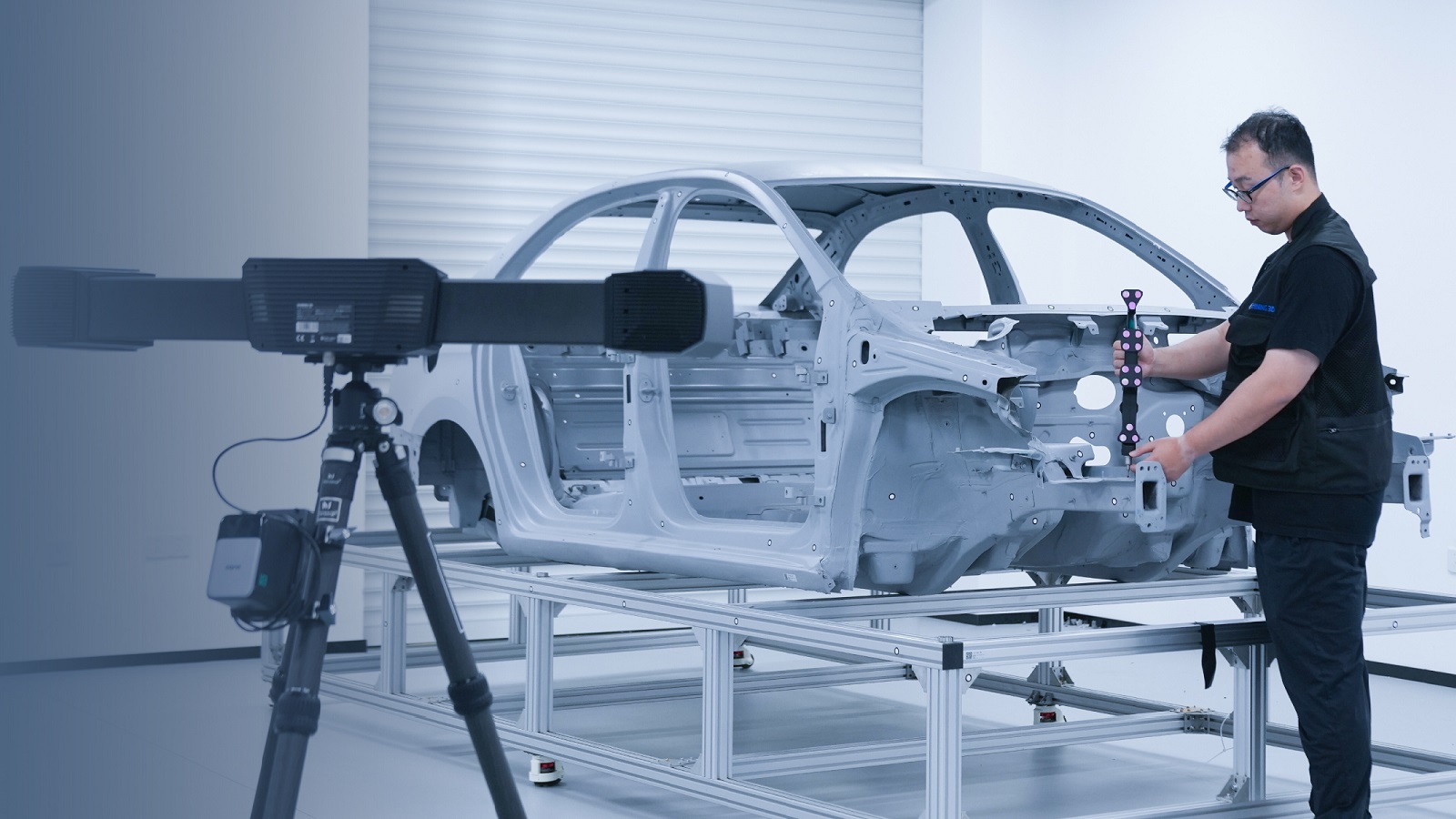

Bridging the Scanning-Probing Divide
For manufacturers striving for complete digital twins of their components, relying solely on scanning can leave critical features undocumented. FreeProbe bridges this gap by combining the best of both worlds: high-speed scanning for overall surface coverage and precision probing for features hidden from optical view.
When paired with FreeScan Trak Nova or ProW, the workflow becomes seamless. Users can alternate between scanning and probing in a single session, ensuring full coverage without the need for repositioning or multiple setups.
