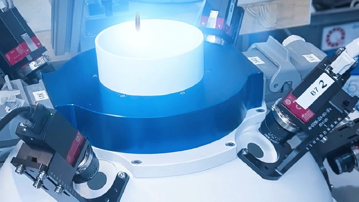

Using a free-fall inspection system, a team from Fraunhofer IPM has succeeded in checking the geometric dimensional accuracy of 3D precision parts in the production cycle for the first time. The system was tested in a production process for plug connectors made of copper sheet, of which 330 parts per minute are manufactured.
Capturing 330 Parts Per Minute  Â
A component feeder developed by the manufacturer transports the individual parts, which are up to 40 mm in size, from the punching machine into a test sphere without any further handling. As the parts fall through the sphere, they are captured from different perspectives by 16 high-resolution cameras. The objects are captured without shadows or reflections due to an indirect LED flash illumination. The measurement data is checked against the nominal CAD model so that defective parts can be ejected immediately. The high processing rate for this computationally intensive analysis is achieved by fast inspection algorithms, parallelized camera control and several evaluation computers. During test operation, defective parts with geometric deviations in the range of 100 micrometers were reliably identified. The measurements were verified on a random basis using CT scans.
