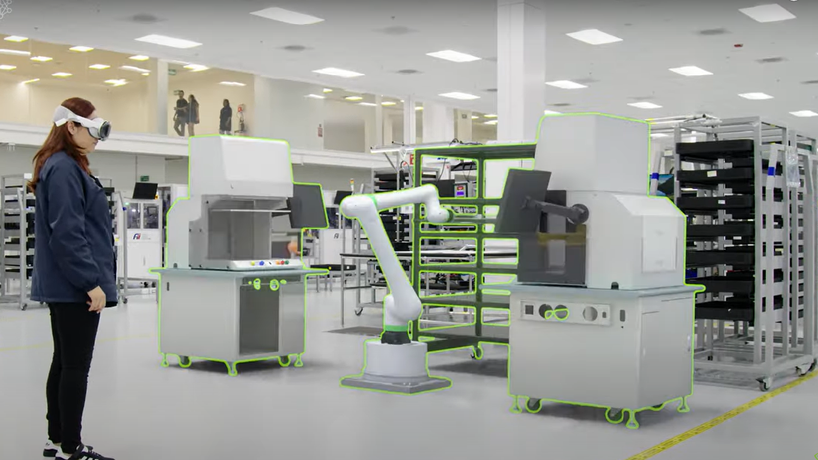

To design an optimal assembly line, factory engineers need to find the best placement for dozens of robotic arms, each weighing hundreds of pounds. To accurately monitor the overall process, they situate thousands of sensors, including many networked video cameras in a matrix to show plant operators all the right details.

Engineers will employ Teamcenter with Omniverse APIs to design robot work cells and assembly lines. Then they’ll use Omniverse to pull all the 3D CAD elements into one virtual factory where their robots will be trained with NVIDIA Isaac Sim.

Inside the Foxconn virtual factory, robot arms from manufacturers such as Epson can learn how to see, grasp and move objects with NVIDIA Isaac Manipulator, a collection of NVIDIA-accelerated libraries and AI foundation models for robot arms. For example, the robot arms may learn how to pick up a Blackwell server and place it on an autonomous mobile robot (AMR). The arms can use Isaac Manipulator’s cuMotion to find inspection paths for products, even when objects are placed in the way.
Foxconn’s AMRs, from Taiwan’s FARobot, will learn how to see and navigate the factory floor using NVIDIA Perceptor, software that helps them build a real-time 3D map that indicates any obstacles. The robot’s routes are generated and optimized by NVIDIA cuOpt, a world-record holding route optimization microservice. Unlike many transport robots that need to stick to carefully drawn lines on the factory floor, these smart AMRs will navigate around obstacles to get wherever they need to go.
