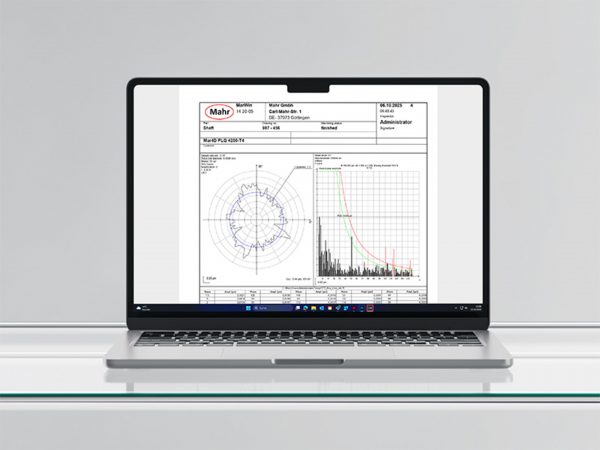

Fourier analysis is a mathematical process that breaks down a measurement profile into its individual vibration components. Modern measurement software such as MarWin from Mahr calculates this analysis using a special algorithm, the so-called Fast Fourier Transformation (FFT). It applies to all periodic profiles such as when the first and last profile points are identical. Fourier analysis is used particularly frequently for circular profiles, as it allows conclusions to be drawn about both the functional properties of the workpiece and the effects of production. The result of the Fourier analysis is typically referred to as a spectrum and displayed as a bar chart. The horizontal axis shows the frequencies (number of wave crests), the vertical axis the amplitude (strength of the vibration). This provides a clear picture of the frequencies contained in the signal and their characteristics. This provides users with an objective basis for making decisions in order to initiate targeted measures and efficiently rectify process deviations.

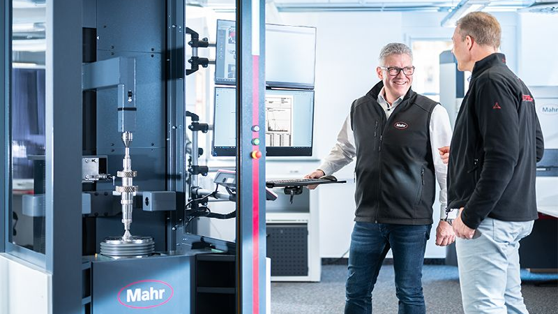

Mahr offers Fourier analysis for
- Tactile measurements in the Mar4D PLQ cylinder coordinate measuring machines
- Form measuring devices of the MarForm series
- MarSurf devices for tactile roughness and contour measurement and
- The OptoSurf series for optical surface analysis.
