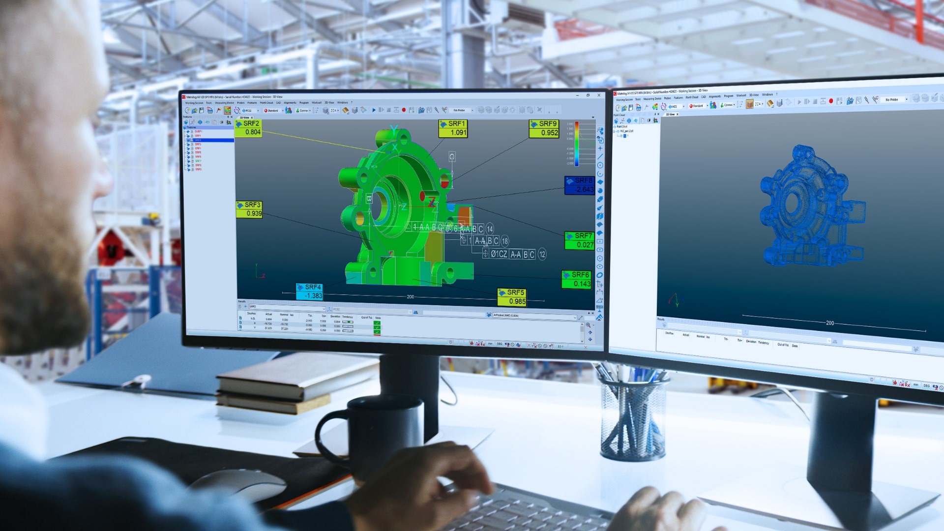

A 3D metrology software solution will merge point cloud data with CAD files into the same place to compare, contrast and analyze measurements via color mapping – a feature that makes it easier and interesting for metrology professionals to read and interpret the data.
