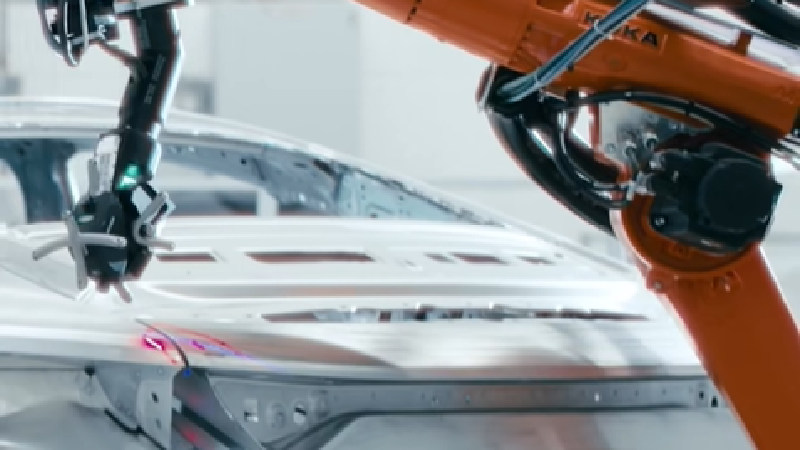

As manufacturers push toward fully automated, lights-out production, inline inspection systems must deliver not only accuracy but also reliability, simplicity, and continuous uptime. EDAS GO meets this challenge by turning complex inspection logic into a zero-touch, appliance-like runtime system.

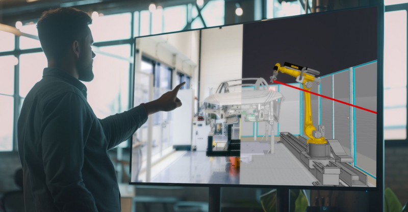

At the heart of EDAS GO is the full EDAS platform, a versatile software environment that unifies design, programming, and metrology in a single framework. EDAS allows engineers to configure measurement strategies, define automation logic, integrate sensors and robots, and simulate inspection workflows before deployment. By combining industrial connectivity, observer-driven automation, and robust recovery features, EDAS provides a comprehensive foundation for reliable, repeatable inline inspection – enabling EDAS GO to deliver a truly zero-touch experience on the production line.
EDAS GO separates engineering from execution. Engineers define measurement strategies, automation logic, and system connectivity in EDAS using Design, Programming, and Metrology Modes. Once validated, projects move to Execution Mode, where EDAS GO enables operators to run inspections without accessing engineering tools.

With engineering handled upfront, runtime simplified, and automation driven by observers and triggers, EDAS GO behaves like a self-contained inspection appliance. Operators launch it, and the cell executes inspections reliably under 24/7 conditions, giving production teams trust in both accuracy and uptime.
EDAS GO demonstrates how sensor-driven, automated inline inspection is evolving – turning complex metrology into a predictable, zero-touch tool for the smart factory of the future.
