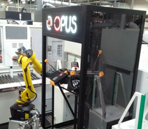

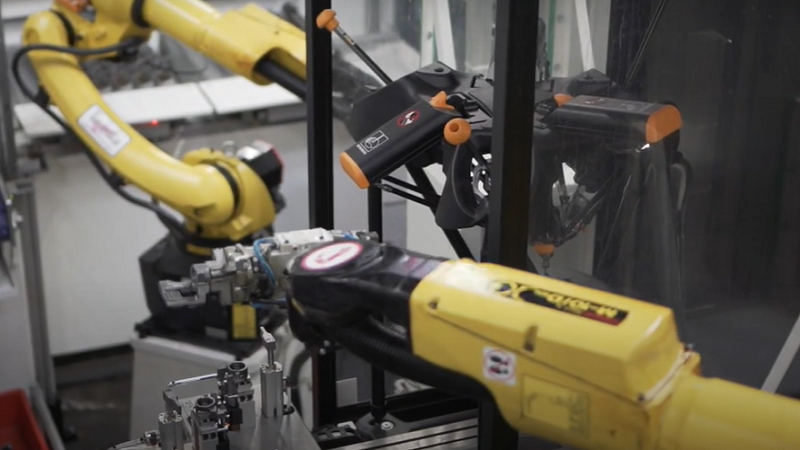

Four Machining Centers and Two Articulated Robots: The machining centers produce the parts, while the robots handle loading/unloading of the centers and the Equator comparator, integrating quality control directly into the production line.
Two Blow-Off Stations: As machined parts are contaminated by chips and cutting oil, the blow-off stations ensure clean, dry partsâideal conditions for precise inspection.

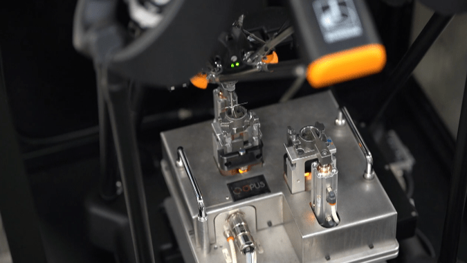

Renishaw Equator Comparator: This system performs rapid and accurate comparisons between machined parts and a reference standard, ensuring consistent quality.

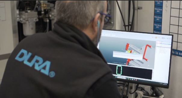

Metrolog X4 Software: At the heart of the system, the universal Metrolog X4 software is programmed by OPUS ST to centralize and automate the measurement of every part. It enables real-time control and adapts easily to different parts, ensuring maximum flexibility.
