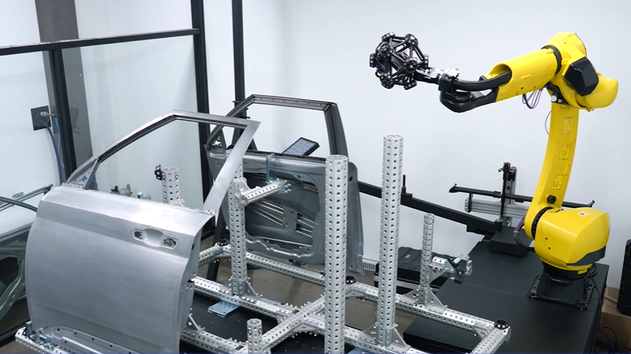

Creaform CUBE-R system inspecting door and rear panels mounted on a modular fixture inside Ajin Industrial’s metrology room.
