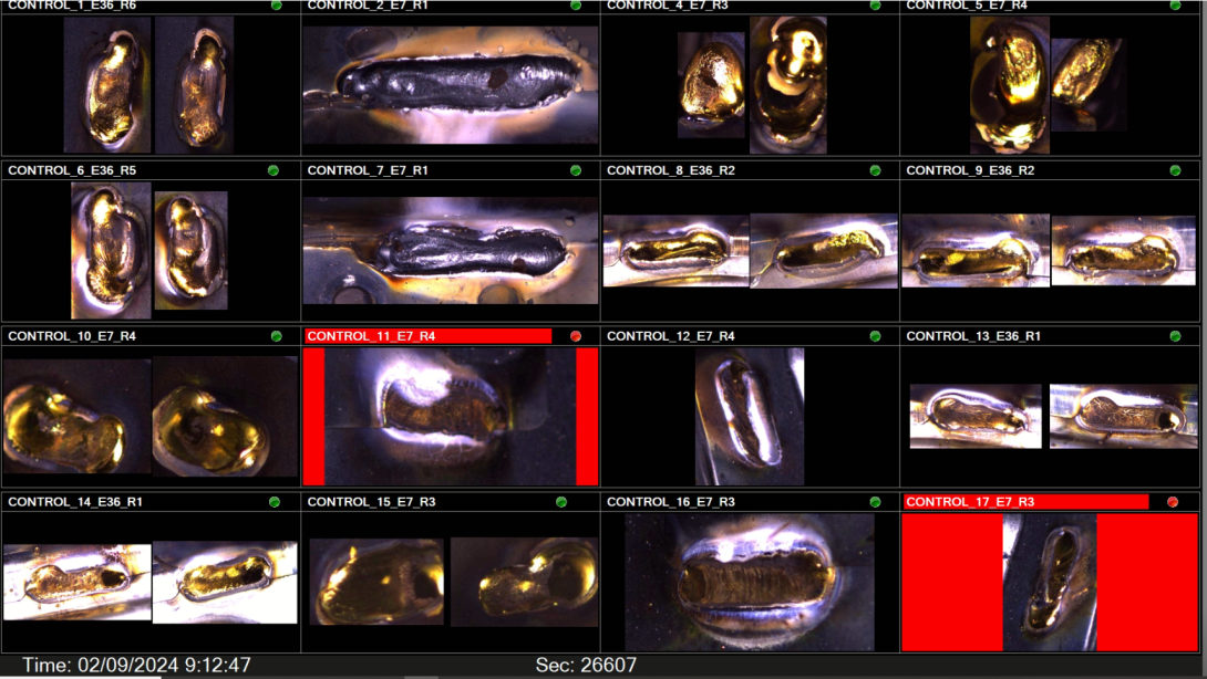

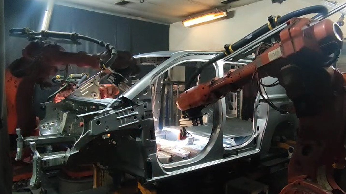

The primary aim of the implementation was to achieve a very high quality standard for all weld seams. In addition, the autonomous quality inspection was to bring the fundamental advantages of automation to bear. Namely, higher speed, reliability, accuracy, and clear consistency during the inspection. To achieve these goals, the system works as follows: When a car body reaches the inspection station, the PLC triggers various inspection processes. 2D cameras take photos of the welded connections individually or successively and transmit the images via GigE Vision protocol to the machine vision software, where the processing takes place. The system checks whether anomalies can be detected around the weld seams by reliably checking different welding joints, seams, and spots that have been created using various laser welding processes. The data is then sent to the PLC and the corresponding results are visualized on a screen.

The MVTec HALCON machine vision software is at the core of the setup. To reliably detect all defects, the software essentially uses two methods based on deep learning AI technology. First, Instance Segmentation is used to precisely localize the relevant area, i.e., the weld seam, on the captured images. Due to deep learning, the method can assign objects to different, trained classes with pixel precision. The next step involves the use of Anomaly Detection technology, which is also based on deep learning. The process uses automated surface inspection to accurately detect all deviations, i.e., defects of any kind.
Inspection of weld seams in bodyshells
“Anomaly detection had two decisive advantages for us: On the one hand, the detection rates are very high and robust. On the other hand, training the underlying neural networks was simple. This is because mainly ‘good images’ of the welded joints, i.e., images of weld seams without defects, were required to train the deep learning networks. However, a few ‘defect images’ can help find an optimal threshold value to differentiate between good and defect weld seams. Ultimately, we only need a small number of good images. This is very practical, as these are available quickly and easily. Large numbers of images showing defects are much more difficult to organize, not to mention the fact that it is impossible to obtain images of all possible defects. This is where deep learning has a clear advantage,” explains Guillermo Martín, Innovation & Technology Director at DGH.
