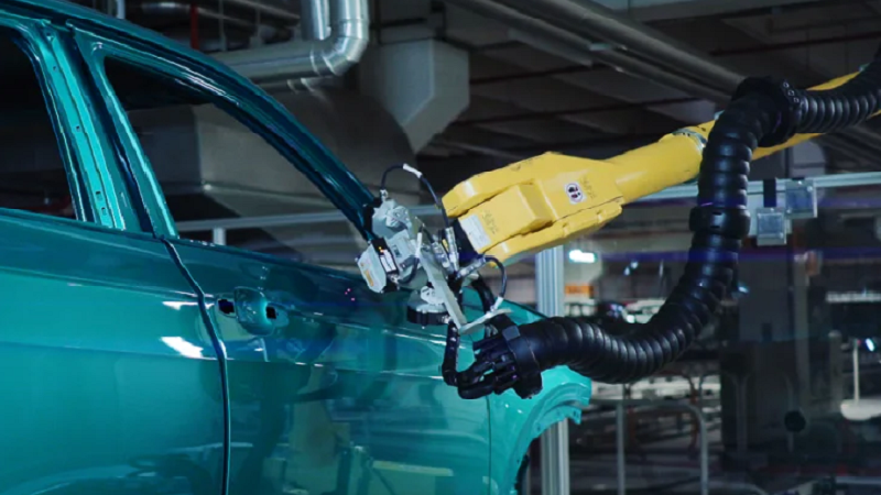

Robotic Integration and Long-Term Stability: Sensor positioning is critical for consistent inline inspection. das‑Nano systems are designed for industrial robot integration, ensuring repeatable measurements with no mechanical drift over time. Unlike vision-based or servo-mounted alternatives, das‑Nano uses triangulation-based positioning, providing:
  • Greater precision on complex geometries
  • Consistent performance regardless of lighting or surface conditions
  • Robust operation in high-speed production environments

At Volkswagen Navarra, das‑Nano’s terahertz-based system has been operational 24/7 since 2020. The plant reports 50 kWh saved per vehicle, totaling over 16 GWh annually and avoiding more than 7,000 tons of CO₂ emissions each year. These results illustrate how precision measurement can directly link production quality with sustainability outcomes.
