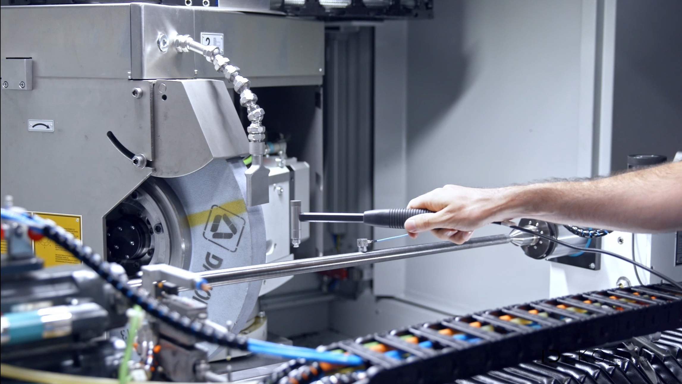

To address this issue, the research centre has developed Fast Dressing Servo (FDS), a technology that enables controlled texturing of components through the grinding wheel dressing process. This approach enhances tribological properties, improving lubrication performance and reducing wear and friction by up to 30%.
This methodology replaces costly and poorly repeatable manual processes, such as scraping, with an automated, efficient and ergonomic solution.
In addition, IDEKO has developed the Virtual Vibration Absorber (VVA), an external actuator designed to eliminate forced vibrations in high-precision machines. This ensures that highly demanding sectors such as energy and aerospace can achieve “zero-defect” targets in their components.

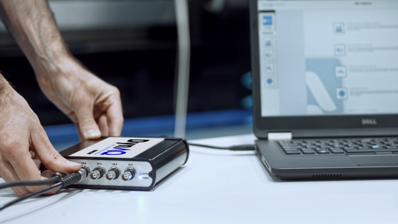

Finally, IDEKO will also present DynAQ at BIEMH, a portable tool combining hardware and software to measure, diagnose and solve vibration-related issues in machines and production equipment, helping to improve efficiency, reliability and availability.
The platform captures signals from multiple sensors, displays their time evolution and performs spectral analysis in a user-friendly way. It has been designed as an intuitive, agile and interactive solution for technical personnel, regardless of their level of expertise in machine dynamics.
