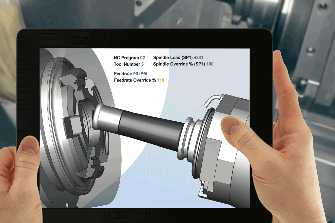

CGTech recently announce a new VERICUT module developed in partnership with Scytec: CNC Machine Connect. This new VERICUT module allows users to connect with the CNC machines on their shop floor using Scytec’s DataXchange software. This data can be used to create and maintain more accurate digital twins through VERICUT Machine Configurations (VMCs), as well as confirm that CNC machines and VERICUT simulations match as closely as possible, to eliminate unexpected surprises on the shop floor during machining.
The current version of CNC Machine Connect available with the launch of VERICUT 9.3 comes with a pre-check capability. Pre-check allows users and machine operators to verify that key aspects of CNC machine and setup information match what was previously verified in VERICUT prior to running the part on the machine. This feature validates critical control parameters that impact machine motion and behavior, main NC program, subprograms, work offsets, cutting tools, and more. Significant differences are clearly identified and can be investigated prior to machining or updated to rerun the VERICUT simulation with data retrieved from the machine to ensure no new problems or unexpected errors are introduced by the current machine setup.
Future releases will add a post-machining capability to provide valuable insight about how NC programs ran on the machine. Users can connect to machines to retrieve current resident data, or access data archived when the machine ran, turning VERICUT into a powerful forensic investigative tool to improve machining processes. Users can identify modifications made to NC programs, overrides used on the machine, and where these occurred during the machining process. This historical data can also be used investigate potential issues that may have caused poor machining conditions leading to poor part quality or parts out of specification.
