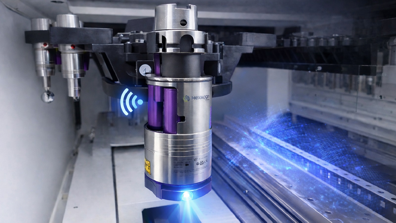

Applied Automation Technologies (AAT3D) has announced the integration of the Hexagon LS-R-4.8 blue light laser scanning sensor into the CAPPS-NC manufacturing platform. The integration enables wireless communication and intelligent automatic tool changer (ATC) management to support high-speed, non-contact inspection of large airframe stringers and complex structural components.
Developed for large-scale aerospace manufacturing environments, the integrated solution supports dense, high-resolution 3D data capture directly within the production environment. The system maintains low-latency wireless communication between the scanning system, the machine tool, and the CAPPS-NC NC-Fit module, enabling in-process measurement workflows.
The integration supports automated handling of the scanning hardware through coordination with the machine’s automatic tool changer. This allows the scanner to be managed as a tool within the machining environment, supporting automated pickup, changeover, stowage, and verification without manual intervention.
