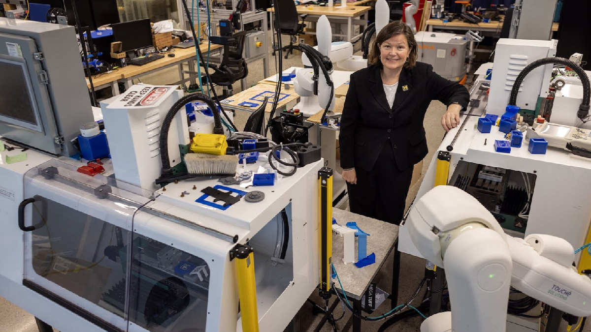

To test out ideas developed through the center and ensure that they operate as intended, U-M offers the SMART 4.0 testbed, featuring a ‘connected factory# of mobile robots, computer-controlled machines and 3D printers, connected through open process automation. ASU provides its own connected smart manufacturing system that includes robotics, programmable logic controllers, smart sensors and RFID tracking for milling and additive manufacturing.
