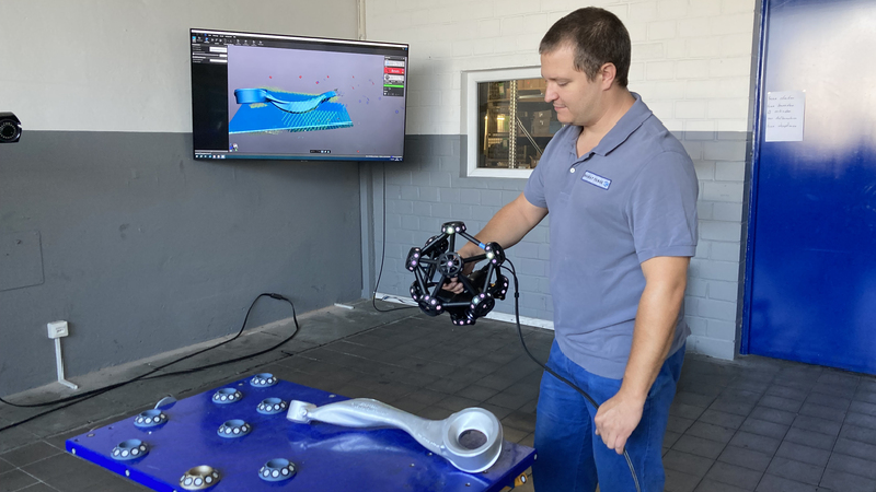

Determined to remain at the forefront of the market, Bharat Forge began searching for more modern 3D measurement technologies. The criteria were clear: Bharat ForgeCDP Gmb needed solutions capable of both tactile and optical measurements, independent of adhesive dots or surface sprays. Portability was key—the 3D measurement solutions needed to be versatile enough to measure components of all sizes and geometries without requiring the parts to be moved to a dedicated lab environment.

The impact of Creaform’s 3D metrology solution was felt almost immediately. The time needed to measure each component dropped dramatically, saving up to 75% of the time previously spent on 3D measurement tasks. “We used to spend up to two hours measuring a single complex component,” Florian Heimbeck described. “Now, that time has been reduced by 1.5 hours per task. It’s a game-changer for our production process.”
Because Creaform’s solutions were more straightforward, the company no longer depended on a small group of highly trained technicians. “With Creaform, five times as many employees can now be deployed for measuring,” said Florian Heimbeck. “We plan to expand this further with additional training, allowing us to take on more projects across multiple shifts.”
A case in point? Bharat ForgeCDP Gmb also fulfilled customer expectations. One specific project involved measuring an aluminum chassis component with free-form surfaces for a renowned OEM. The customer expected optical measurement for initial samples and tests during series production—a task that would have been nearly impossible with legacy systems. “Creaform 3D scanners and integrated software allowed us to meet the customer’s exact specifications while saving time and improving accuracy. It’s been crucial in maintaining our relationships and securing follow-up orders.”
