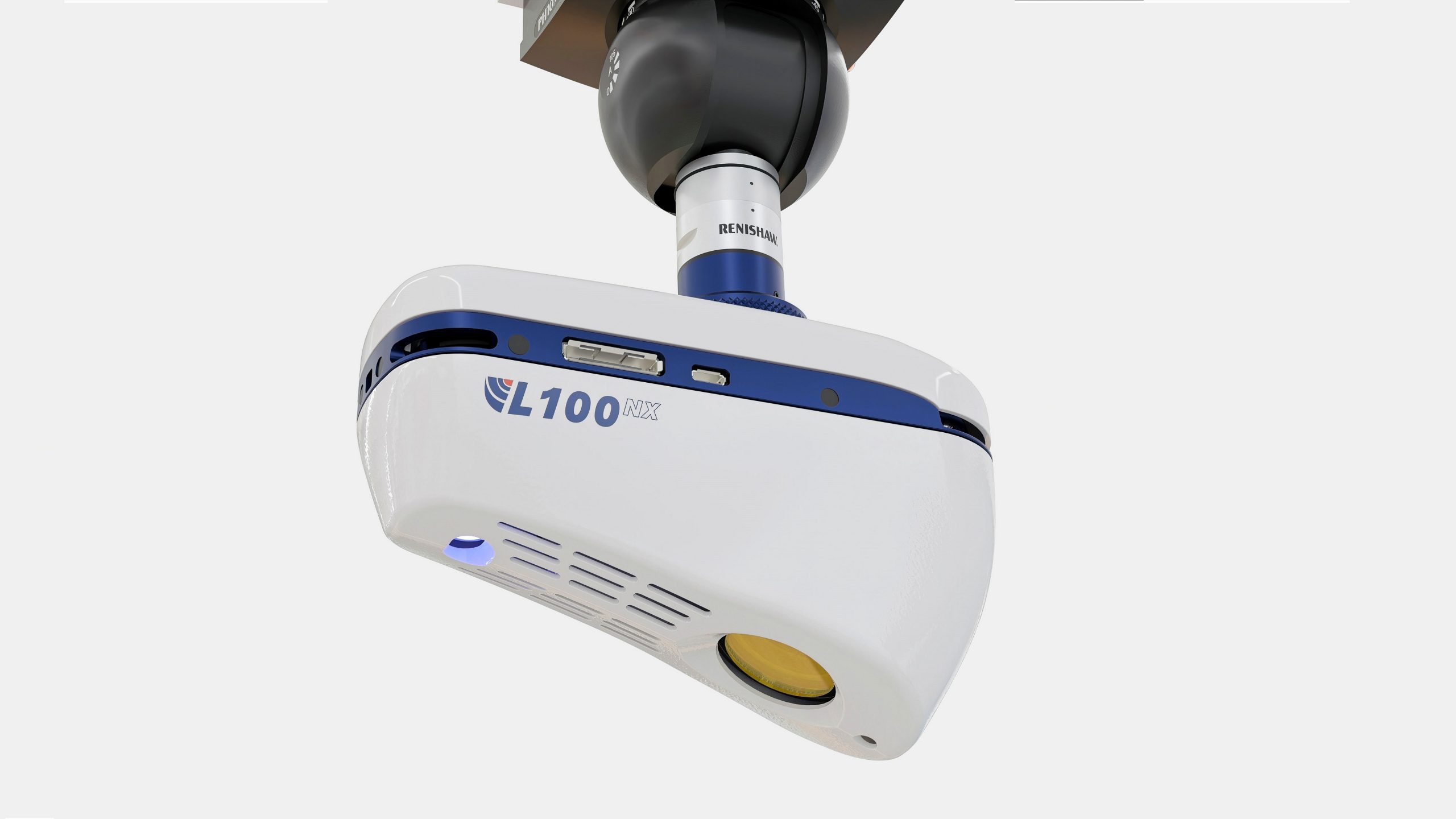

A next-generation laser scanner designed for use on coordinate measuring machines (CMMs) has been launched by LK Metrology, a global leader in precision metrology solutions. Building on the success of the L100, the new L100NX introduces advanced blue laser technology, delivering superior scanning performance, accuracy and user experience.

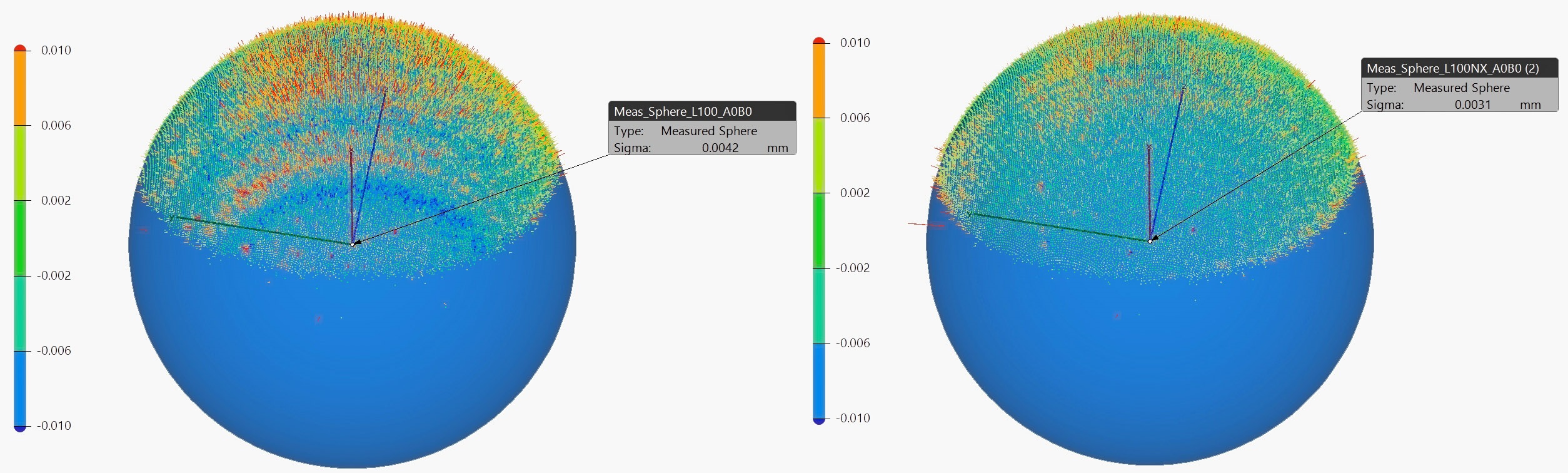

Unlike its predecessor, which utilised red laser light, the new scanner employs a 450-nanometre blue light laser that significantly reduces noise in scan data, resulting in cleaner and more reliable measurements. This advance is particularly beneficial for high-precision applications where data integrity is critical, such as in the aerospace and automotive sectors.
The L100NX combines speed and precision with a wide stripe width of 110 mm and a scanning rate of up to 530,000 points per second, making it ideal for inspecting large components productively. Its high accuracy ensures that even the most demanding inspection tasks may be handled with confidence.
At the heart of the L100NX is LK’s 4th-generation ESP (enhanced sensor performance) technology, which intelligently adjusts laser power for all of the 2,000 points on the laser line. This allows the scanner to measure multi-material assemblies and shiny surfaces seamlessly without surface preparation or other manual intervention, streamlining the inspection process and reducing operator workload.
To further enhance usability, the sensor features an integrated rotation adaptor, enabling optimal orientation of the scanner for inspecting complex part geometries. Additionally, an integrated FOV (field of view) projector visually displays the scanner’s coverage area directly onto the part, simplifying programming and setup.
