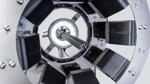

The AllRounDia DualVision system from PIXARGUS continuously checks the contours and surfaces of hoses, tubes and cables – around the products’ complete circumference and along their complete length. This affordable multi-talent has been tested on a wide range of standard applications, is extremely user-friendly and – as a truly Plug-and-Play system – providing 100% defect control.

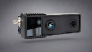

The AllRounDia DualVision system is based on PIXARGUS’ successful and proven ProfilControl-7 technology. It has been adapted and further optimized for the measurement of plain round shapes. The result is a high-performance small-budget system for round long products that requires almost no setup effort, not even for the illumination or the cameras’ viewing angles – a truly self-adjusting system with straightforward functionality and inspection straight to the point.

AllRounDia DualVision checks the contours and surfaces of round long products. It handles all colours and all surfaces, matt or glossy, and even surfaces of translucent and semi-transparent tubes with ease. A newly developed lighting concept ensures that the field of vision and the measuring field are always perfectly lit. Thus, even difficult to detect irregularities and flaws in the material, such as fissures, inclusions, flecks and other high-contrast defects from a size of 0.5 mm, are reliably detected.
