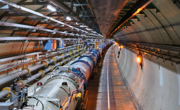

Located near Geneva on the French-Swiss border, the LHC accelerates particles to nearly the speed of light to explore the fundamental structure of matter. The machine is central to some of the most significant discoveries in modern physics, including the confirmation of the Higgs boson.
Inside the collider, particles travel through beamlines maintained under ultra-high vacuum and surrounded by superconducting magnets operating at approximately –271 °C, just above absolute zero. These conditions enable precise particle acceleration but create formidable challenges for inspection and maintenance.
The LHC contains roughly 2,000 Plug-In Modules (PIMs) within its beamline infrastructure. These modules incorporate delicate components such as radio-frequency (RF) fingers, which maintain electrical continuity along the beam pipe. Over time, repeated thermal cycling can cause these thin metal contacts to deform slightly.
Even microscopic distortions can protrude into the beam path. In a system operating with sub-millimetre tolerances, such changes may obstruct particle beams, potentially disrupting experiments and requiring complex maintenance interventions.

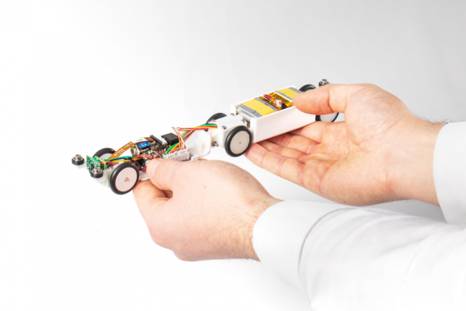

The resulting solution is PipeINEER, a robot measuring just 20 cm in length and capable of navigating spaces only 3.7 cm by 3.7 cm wide.
Despite its tiny dimensions, the robot is engineered for extended missions. Operating autonomously, it can travel up to six kilometres on a single battery charge, the equivalent of traversing roughly 60 football pitches end-to-end, while capturing detailed images of the beamline components.
This capability represents a significant step forward compared with traditional pipe inspection technologies, which typically require tethered systems or frequent retrieval.

A key feature of PipeINEER is its AI-assisted inspection capability. As the robot travels through the beamline, onboard cameras capture high-resolution imagery of the Plug-In Modules and surrounding components.
Machine-learning algorithms trained on real LHC imagery analyse these images to identify anomalies such as:
  • Bent or displaced RF fingers
  • Surface deformation or obstruction
  • Foreign objects or contamination within the beamline
If the system detects a potential issue, the robot autonomously returns to its entry point and reports the precise location of the anomaly.
