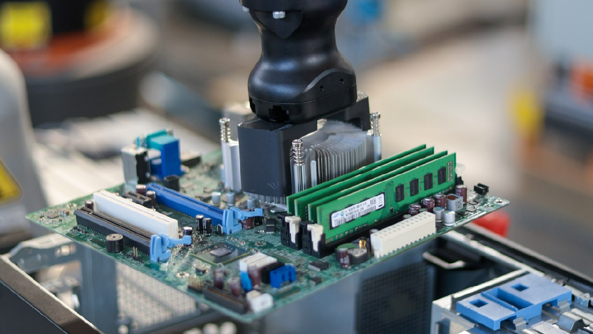

Industrial robot lifting motherboard from a PC

In the next step, Saenz and his team define the disassembly sequence so that their software can determine whether to execute a complete disassembly or only focus on the recovery of specific, valuable components. Glued or otherwise mated components hinder nondestructive disassembly. Rusty or stripped screws or deformed components are not ideal for this either. The disassembly process starts based on this high-level information. The robot receives a series of instructions and operations to complete, such as “Remove two screws on the left of the housing, open the housing”. Whenever necessary, the machine changes each tool needed in between the individual steps. The skills specified in the disassembly sequences include robot actions, such as screwing, lifting, cutting, extracting, localizing, repositioning, releasing, moving levers, bending, breaking and cutting wires, which the disassembly robot can perform completely autonomously. The demonstrator even succeeded in tests to remove a motherboard from a computer—a very complex task that requires a high level of precision. “We used AI for that. An AI agent is initially trained to complete the process on the simulation model and later we transfer the trained robot action to the real-world experimental setup. This isn’t necessary for simple skills, such as localization. We use sensor and camera data for that,” Saenz explains.
