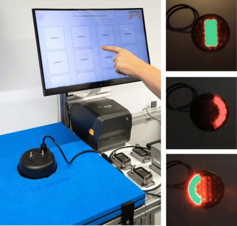

Aspöck Systems manufactures multi-chamber lamps for vehicles, which must be reliably tested at the end of the production line. The decisive factor is not only whether a lamp lights up, but also whether the correct chamber is enabled. A turn signal must not accidentally activate the rear fog light – a mistake that could have serious consequences on the road. Added to this are typical production conditions: different orientations of components, extraneous light in the hall, dust and dirt, and a wide variety of variants. Classic systems based on fixed test rules reach their limits here. Every product change involves a great deal of adjustment work, and unexpected error patterns are difficult to identify reliably.

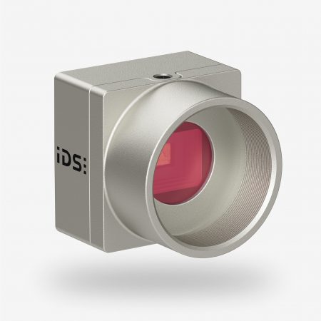

The IDS U3-3680XCP Rev.1.2 used features the 5.04 MP rolling shutter CMOS sensor onsemi AR0521 and consistently delivers detailed, low-noise images, even in challenging lighting conditions. Back Side Illumination technology ensures high sensitivity and low noise levels, offering a clear advantage in low ambient light or dirty conditions.
“The combination of compact size, robust design, and superior low-light performance makes this model the ideal component for demanding end-of-line inspections,” emphasizes Jürgen Hejna, Product Owner 2D Cameras at IDS. In addition, the IDS peak software environment facilitates the connection of cameras and significantly reduces the integration effort. “Thanks to IDS peak, we were able to get the solution up and running very quickly and integrate it swiftly into the existing production environment at Aspöck,” adds Nico Teringl.

During operation, the multi-chamber lamps are enabled individually by a control system. Two identical IDS cameras capture the images, which are then evaluated on the Industrial PC using AI. The two cameras operate in parallel: While one product is being tested, the next product can already be placed on the test bench. This parallel approach increases cycle time and boosts efficiency. A key advantage of the solution is local processing without the cloud: This guarantees full data sovereignty, high reliability, and minimal latency which is a crucial factor for Aspöck Systems, where production downtime must be avoided at all costs. The solution is independent of the exact alignment of the lamps and robust against environmental variables such as extraneous light or contamination.
The results are displayed in real time on an HMI touchscreen, automatically logged, and can be transmitted to the higher-level production system via an API. This creates a closed inspection process that replaces or effectively supplements manual visual inspections while ensuring complete traceability.
