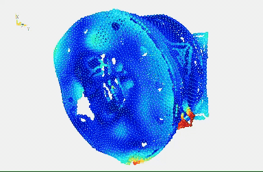

ODS at 4.6 kHz

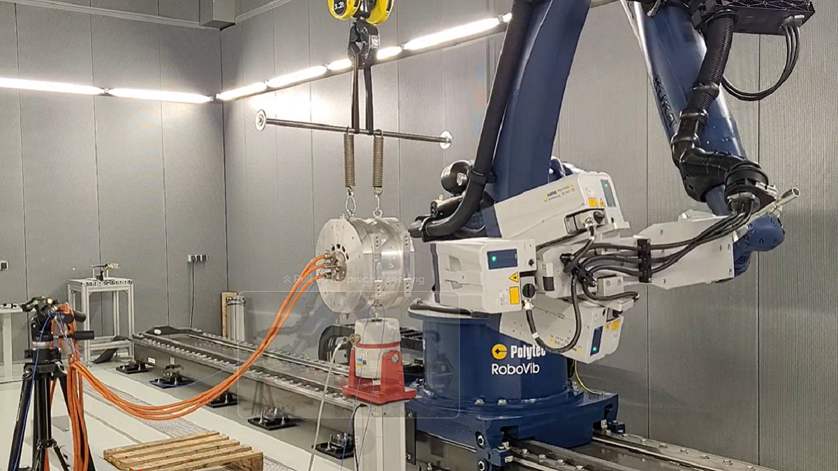

These capabilities are demonstrated through the experimental modal analysis of an electric drive carried out at Polytec’s fully automated RoboVib test center. The goal of the investigation is to characterize the structural-dynamic transmission behavior of the drive – describing its natural frequencies, mode shapes (eigenvectors), and damping—and to compare the results with numerical simulation models.

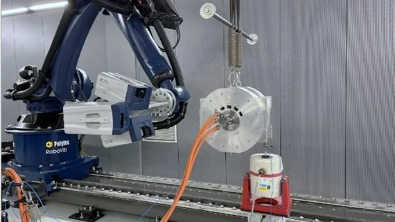

To ensure realistic and repeatable boundary conditions, the electric drive is elastically suspended using springs. This suspension minimizes external influences while allowing the structure to vibrate freely. The stiffness of the springs is carefully selected so that the suspension’s natural frequency is well separated from the first expected natural frequency of the machine itself. This approach ensures that the suspension has minimal impact on the measured damping behavior of the drive.

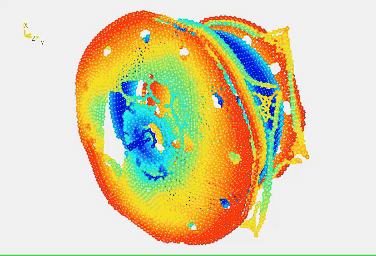

ODS at 9.8 kHz
A key aspect of experimental modal analysis is the controlled excitation of the structure. In the RoboVib test center, several excitation methods and signal types are available to suit different investigation needs. The study explores excitation using an LDS shaker driven by pseudo-noise and white noise signals, as well as excitation using an automatic modal hammer from NV-Tech.
When employing the automatic modal hammer, thin hardened steel plates are attached at the excitation points to prevent plastic deformation of the machine housing. These excitation points are not chosen arbitrarily; instead, they are determined in advance using specially developed methods that take into account the test boundary conditions within the numerical model. This ensures optimal energy input into the structure and improves the quality of the measured frequency response functions.
The test setup makes it possible to carry out an experimental modal analysis of the electrical drive up to 12 kHz. The illustrations show deflection shapes at selected resonance frequencies..

Measuring the vibration response of an electric drive presents additional complexity due to its curved and geometrically intricate surface. To maintain optimal laser incidence and signal quality, multiple positions of the vibrometer are required. In this case, two different laser Doppler vibrometers, the PSV Xtra and the PSV QTec, are used.
The RoboVib measurement system handles this complexity through full automation. The robot repositions the vibrometer with high repeat accuracy, performing measurements from a total of 17 different positions to capture the complete vibration behavior of the machine. This automated approach not only ensures consistent data quality, but also makes it practical to acquire the large number of measurement points required for high-frequency analysis.

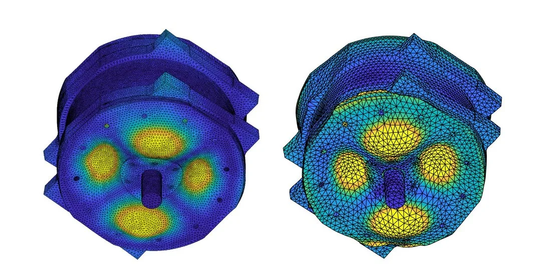

One of the most important outcomes of the study is the correlation between experimental results and numerical models. While simulations can capture general trends in vibration behavior, the comparison clearly shows that current calculation methods are unable to describe the vibration response of electrical machines with high accuracy across the entire frequency range—particularly when it comes to damping.
This finding underscores a critical reality for electric drive development: numerical methods, while indispensable, cannot yet fully replace physical measurement. High-fidelity experimental data remains essential, both to validate models and to guide improvements in simulation methodologies.
Comparison of eigenvectors from simulation and measurement on the drive side at 4.1 kHz
