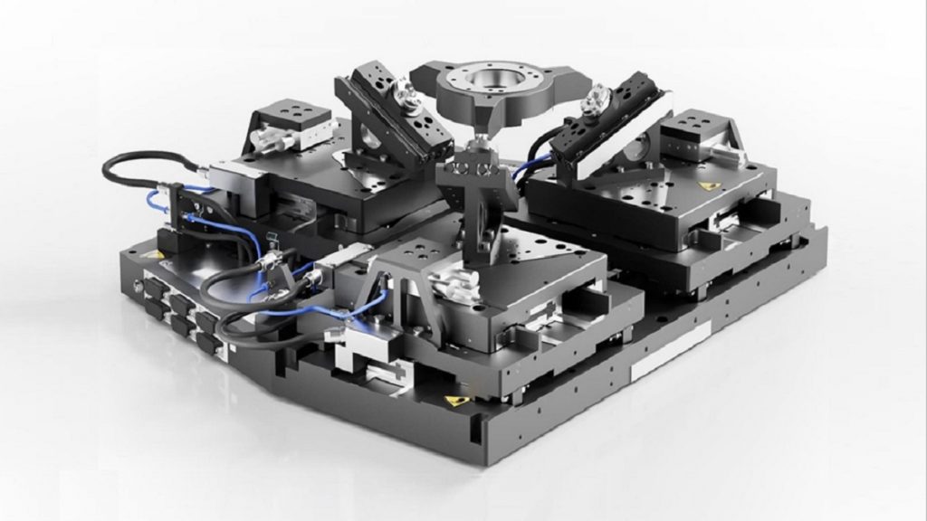

PI (Physik Instrumente), a global leader in precision motion control solutions, has announced the release of the F-690.S1 SpaceFAB, a high-performance 6-axis motorized positioning stage platform, designed for advanced automation tasks that demand high speed, precision, and reliability.
6-DOF Architecture for High Dynamics and Repeatability
The F-690.S1 is built on a unique hybrid kinematic design featuring three symmetrically arranged XY nanopositioning stages with direct-drive linear motors and cross-roller bearings. Each stage supports a linear bearing mounted on a wedge with ball-joint connections, enabling full 6-degree-of-freedom motion (X, Y, Z, pitch, yaw, roll) with smooth coordination and minimal mechanical crosstalk.
Absolute encoders provide 1 nanometer resolution, while pneumatic brakes ensure positional safety during power loss. The compact, low-profile system supports payloads up to 2kg and is capable of operating in inverted orientations, making it ideal for space-constrained or vertically integrated setups.
