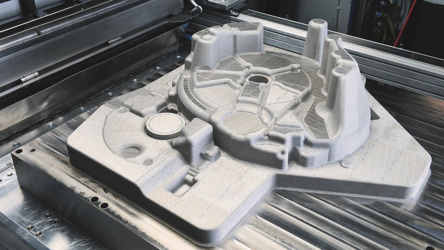

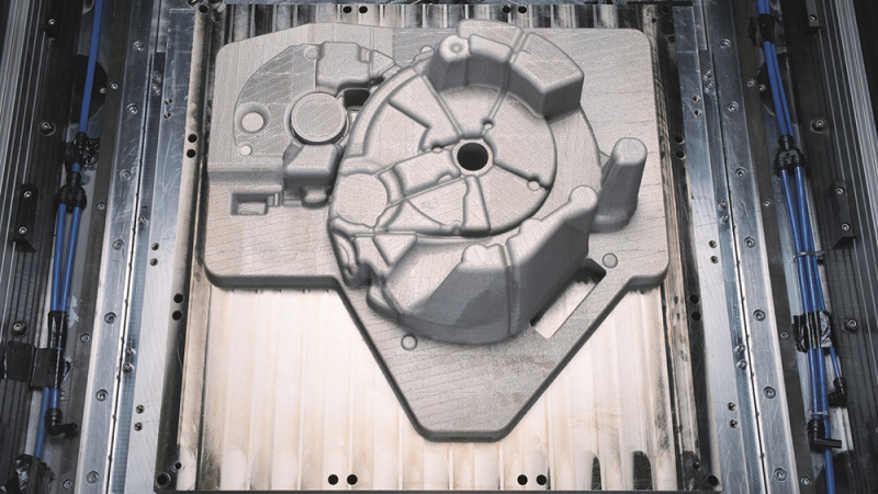

Due to the gantry-based large-format system at Fraunhofer ILT, even complex, resistant tools with a volume of over 20,000 cm³ can be printed reproducibly – a milestone for industrial applications in aluminum die casting.
To address these limitations, Fraunhofer ILT developed a gantry-based, five-laser PBF-LB/M machine with a build volume of 1,000 x 800 x 350 mm³. The system employs a movable processing head and localized shielding gas guidance, enabling scalability along the machine axes while maintaining stable process conditions. A heated substrate platform—reaching 200 °C—further reduces thermal stresses, mitigating cracking risks in large builds.
Central to the success of this project is the L-40 tool steel from MacLean-Fogg, engineered specifically for additive manufacturing. L-40 delivers high hardness (48 HRC), tensile strength (1420 MPa), and notched impact strength (>60 J), while showing a much lower tendency to crack during both the build process and subsequent heat treatment.
“The key to success lies in the L-40 material from MacLean-Fogg, which is tailored to the requirements of PBF-LB/M,” explains Niklas Prätzsch, Group Leader LPBF Process Technology at Fraunhofer ILT.
Hybrid Tool Production for Industrial Application
The project team applied a hybrid production approach, combining conventionally manufactured preforms with additively built sections. The gearbox housing tool insert produced for Toyota integrates near-contour cooling channels impossible to achieve using conventional machining. These cooling structures significantly lower thermal loads in critical zones, extending service life—by up to four times compared to conventional H13 molds in earlier projects.
After additive manufacturing, the tool insert underwent stress-relief annealing before receiving precision milling on functional surfaces. Due to the dimensional accuracy of the additively built base, only light finishing was required.

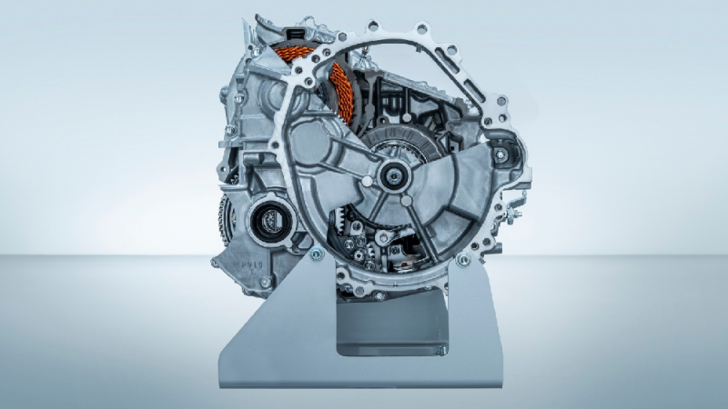

The additively manufactured aluminum die-cast tool is part of the tool for the transmission housing of the Toyota Yaris hybrid vehicle.
