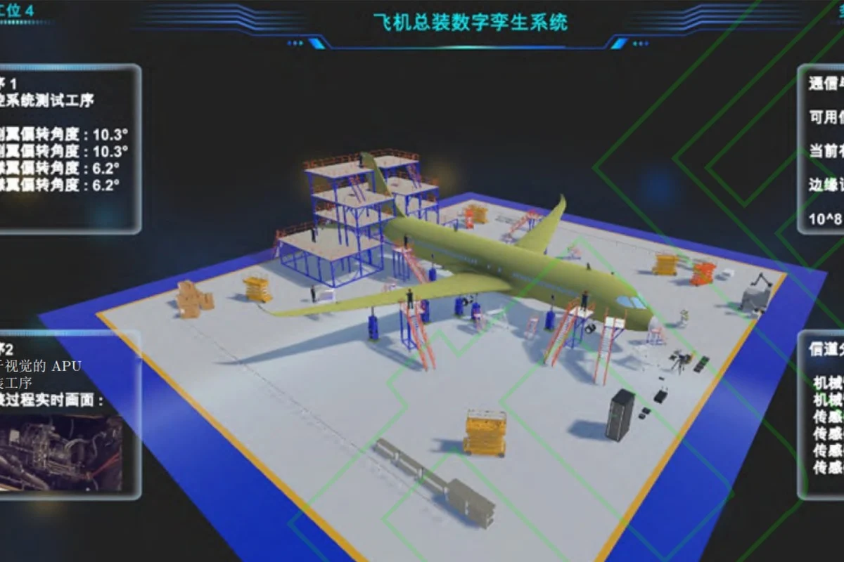

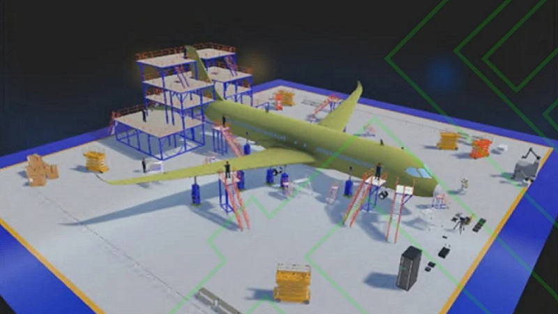

Their solution is high-fidelity digital twin technology. A virtual replica of the aircraft and its assembly environment is continuously updated with live data from the production floor.
As workers assemble the plane, their actions are mirrored in the digital twin. Cameras and motion sensors track their movements and tool usage, while wireless sensors such as angle sensors, gyroscopes and laser rangefinders monitor the plane’s conditions.
This not only reduces quality issues but also speeds up the assembly process significantly, according to the researchers.
For example, when testing flight control systems, the digital twin compares the pilot’s input in the cockpit with the actual movement of the ailerons or elevators.
Any mismatch – say, a surface that does not respond correctly – is instantly flagged, allowing engineers to diagnose and fix issues before they cause a serious delay.
